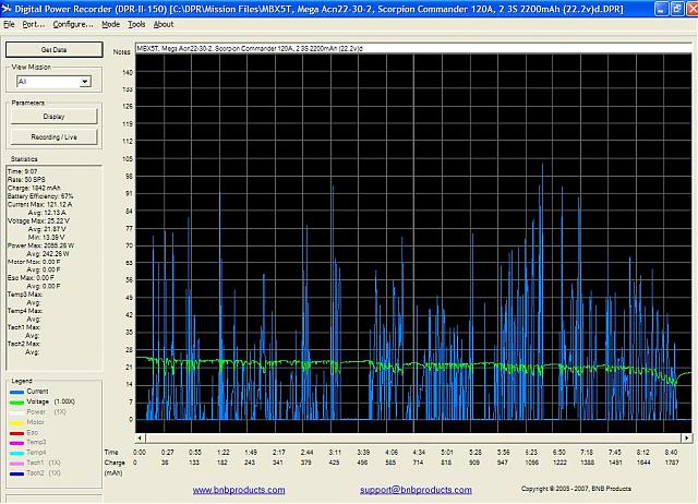

When you get bored with that one, I will take it off your hands if George will allow. I want to see how well it starts up an outrunner in a bind, more specifically the motors that George makes for me! I suppose I should just email him direct about it.
This controller is doing an amazing job of starting the Mega without any issues. I just ran it again and I'm more impressed now. I ran my truck on a football field and it was awesome and you can really feel the difference with the Motor Start Booster. The controller ran cool for 8 minutes as the pack dumped on me. I can't complain and it put out a max of 2055 watts, avg. of 242 watts and a max of 121A, avg. of 12A. Not bad at all. The Mega is getting a beating though.

I'm using the ACn22/30/2. Yes, the controller has forward/brake/reverse and I just came back from testing it again with the reverse option on and it works good.
Here are the Brake Settings:
1*: *No Brakes
2: Very soft brake
3: Soft brake
4: Hard brake
5: Very hard brake
*Default
Scorpion will offer 3 HV controllers as well, 2 will be 12S and one will be 15S. Scorpion will be using a better PCB for the new controllers to lower the resistance.
