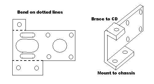

Hey, just bend yourself one of these. (I made you a sweet technical drawing)
01.21.2009, 01:44 PM
Quite gangster, I like it... Just use some decent thinckness steel plate, like 1/16" and use a long turnbuckle to brace the top forward to the sevo mount. About the best DIY solution yet that I have seen!

He says he has plenty of the 1/8 aluminum, which I think would be less flexible than 1/16 steel. Steel would be easier to bend, though. ...And thanks! That took me all of 5 min. to sketch in MS Paint!

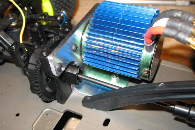

Why not simply stick with the L bracket idea, but also secure it to the CD mount? Something like this:
Edit Apparently my site isn't working right now so I attached the image instead...
This was on a CRT.5 using 3mm thick 6061-T6 aluminum, but you could use thicker material (I would go with 4mm 6061-T6 or 7075-T6).

Good idea Brian, my gtp bracket for the kb 45 motor looks very similar. I trimmed it a bit as I used 2x3 6061 angle. Works fine for me. Attaching it to the rear center diff bulkhead does help with rigidity.
