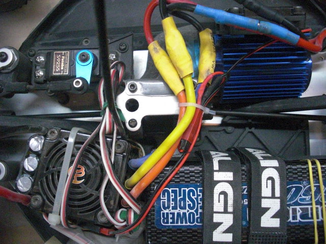

See my similar e buggy - 03.20.2009, 11:34 AM
Running at 4S using 2350 KV brushless
