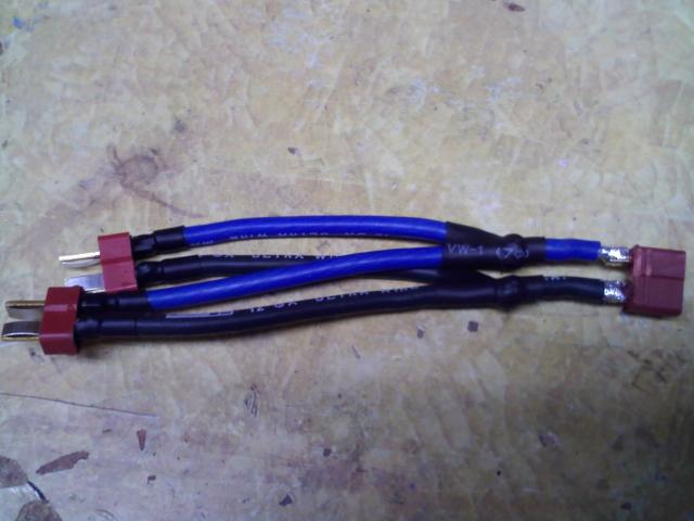

I have two 2s 5000mah packs and want to run them as a single 4s 5000mah pack. Looking at the picture, is my harness correct? I ask because when I check the reading at the pack it is 7.4v and when I plug them both in and take a reading at the new plug, it is the same as one pack. Shouldn't it read 14.8v or close to it?

No, you wired up for 7.4v 10,000mah.

For a series connection you need to do the other one. It makes a triangle... You made a parallel.
Imagine you are adding cells to the existing pack. You'll need to keep the +/- thing going.

Dang! So how should I have wired it exactly?

04.24.2009, 11:59 PM
Like this:
