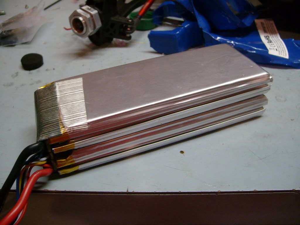

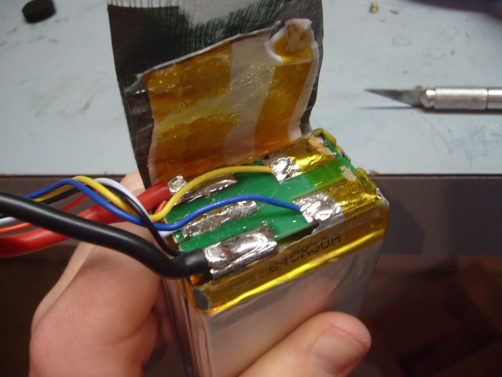

thought I'd post what a zippy looks like
I taped the cells togeter. It actually seemed like they had some kind of tape or glue in between the cells as I tried to pull two apart and I couldn't. I taped them and then shrunk it black.
The shrinkwrapping actually turned out good this time because I have aquired a hair dryer! It "Fell apart when [she] picked it up". The handle is gone and the switches are bare, but it's hot enough and better then a lighter!

Solder job on the flightmax packs is not as user friendly as the zippy H packs...

Wow, look at the solder joint with the positive red wire...
Weak, hope you fixed that before you reshrunk it?

I find the zippy lipos do not have much of the main leads stripped and tinned, I usually like to have at least 3/8 of an inch of tinned wire to make contact on the solder pad.
