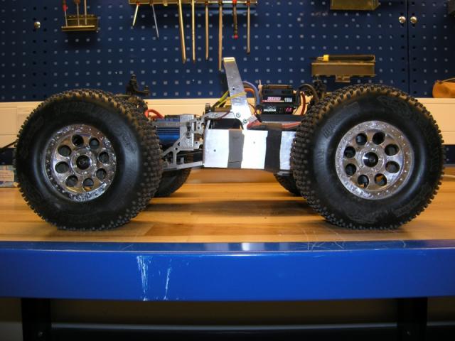

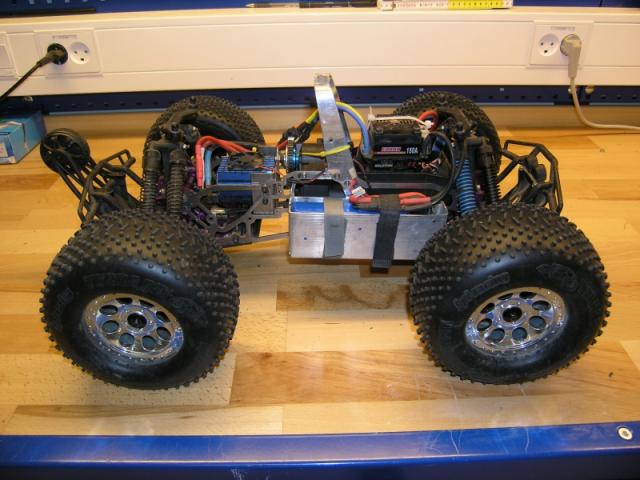

Motor mount & battery trays on the chassis
Will shorten the wireing as much as possible once I figure out where to put the ESC.

Conversion is starting to take shape. Have you thought about mounting the ESC above the tranny? Just make a plate and you're done. As far as a cheap steering servo goes, the hitec HS-5645MG is great. Good specs and about $50 USD.

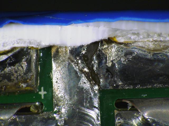

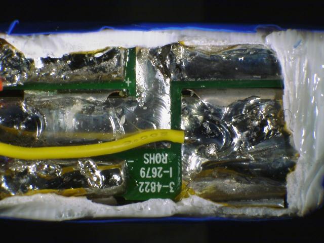

Had a minor problem with one of the Turnigy batteries. On of the tracks on the PCB where all the wires are soldered simply burned over:
Fixed it with some fat wire and solder... but slightly annoyed. I want to buy great quality at low cost damn it!!!
I covered the solder pads which I didn't need to work on with insulation tape. Shorts in a LiPo is bad I hear! Just a little security tip if anyone reads this and has to do similar repair work.

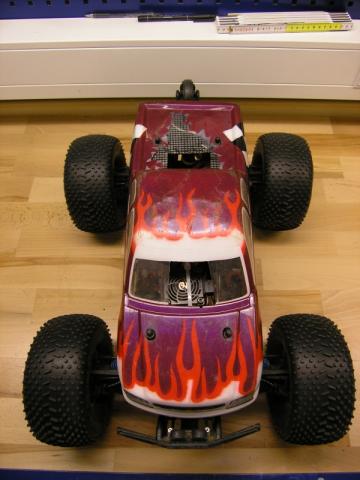

Nixpus
Posts: 138
Join Date: May 2009
Location: Denmark
09.15.2009, 10:33 AM
Servo saver tightened... its slightly out of shape after a crash and seems to allow more slippage now. Thank you for the imput :)

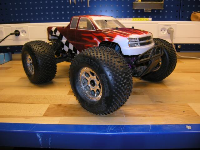

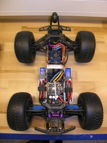

Pictures inc...
ID:	7716   Click image for larger version
ID:	7717   Click image for larger version
  (#45)
Nixpus
Posts: 138
Join Date: May 2009
Location: Denmark
09.15.2009, 10:55 AM
last one...
Looks pretty ok to me... but of course the increased wheel diameter will also lift the CoG
Anyone with imput on FLM chassis vs standard in terms of manouverability?
