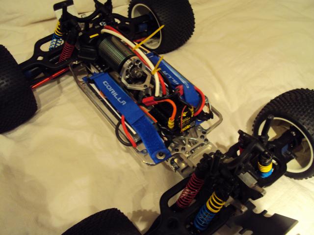

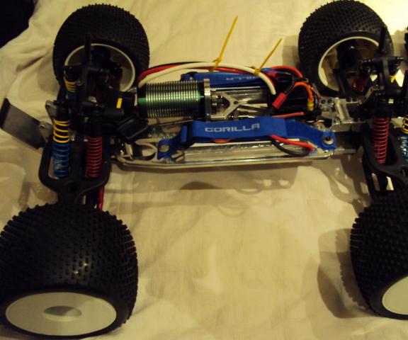

Here are some more pictures of my build.
Suspension is UE's EXT Pro, driveshafts are X1 CRT universals so I can use my 17mm Dace hub adapters, front shocks are UE supershocks while the rears are ST RR fronts. I will be running either 5 S 4100 in parallel or 5S 5000mah in series.

That's looking good George... do you have any shots from the side of the truck illustrating how low the motor is really sits? ...hmmmmm... I'm wanting a set of those arms now... they look so good on any truck... nice build man.

Lito, 5s 5000 in a series, i'm assuming you are talking about using a 2s and 3s in a series correct?
I will be running a 2S and 3S for 5S in series (I currently have 2 x 2S and 2 x 3S Neu 5000mah batts for my son's buggy, 2 battery conversion setup from Castle). However, I will also be running a pair of 5S 4100 mah Neu batteries in parallel for long runtimes (I have 4 of them that I bought from Neu sale $85 apiece).
Angry-alien, here a shot you requested. Clearance/gap is about 6-8mm.
Gap between the motor and chassis is about 7mm.
Turck is finally finished but I will not be able to run it this weekend because of rain . I'll get a video once I get a chance to run it.
Thanks Lito... that's really low in there...
