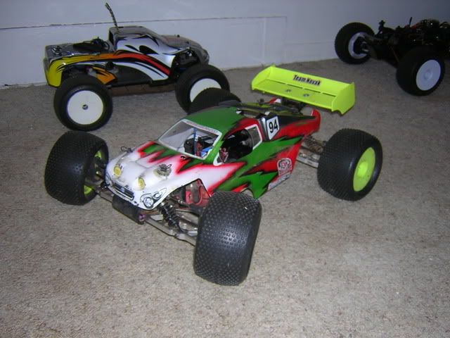

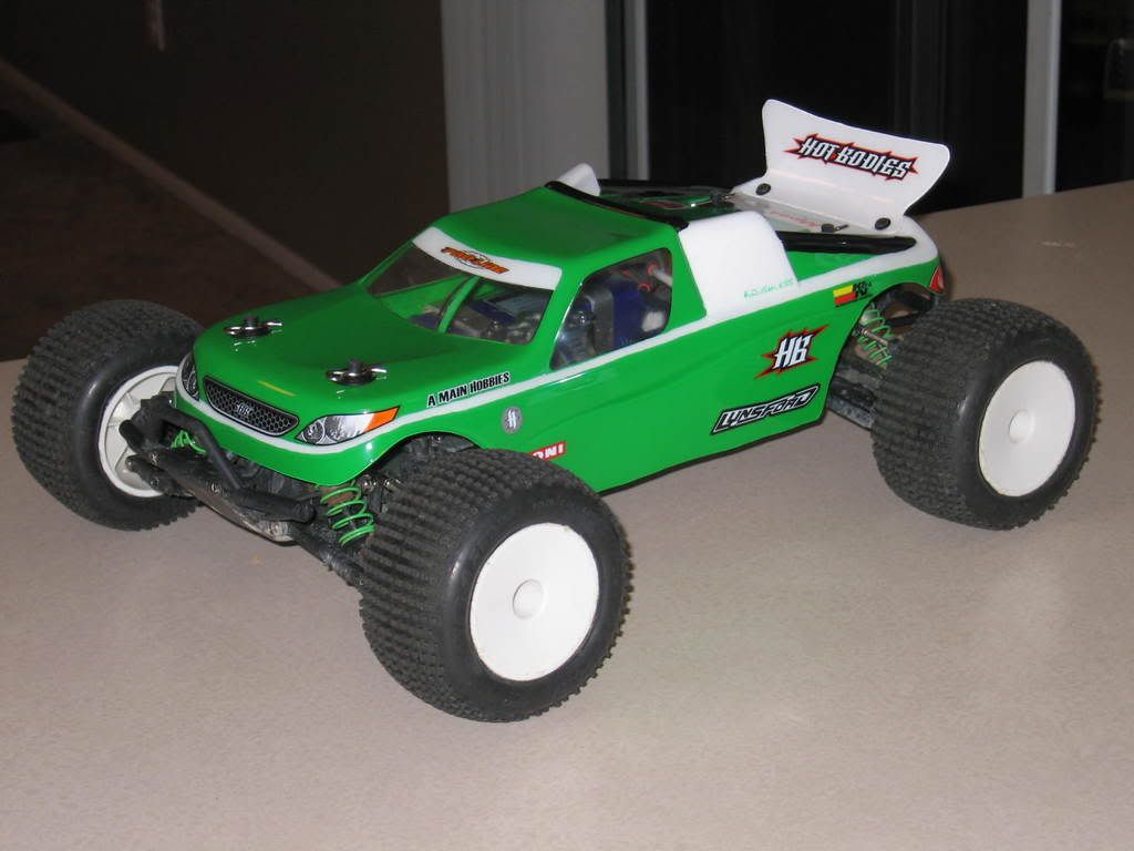

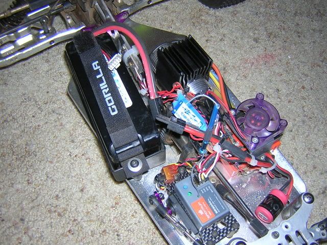

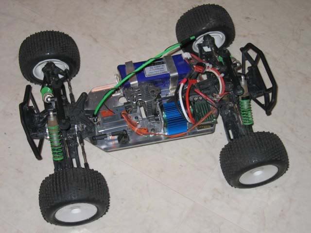

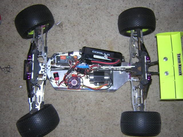

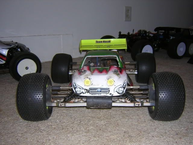

Pics show a 2200 castle motor but now a 1518 resides in it running on 5s
Also using LST2 axles and Cen 23mm hubs
Number 2 that I sold last year

The top truck which I still have, is geared for 41mph. I only bash w/it, and a fine basher it is !
The other one I sold was set up for the track and it worked very well but I feel that the LSP isn't as refined as the newer truggys. It doesn't seem to steer and handle as well, maybe in the hands of a lesser driver it wouldn't be as noticable but to me it was.
