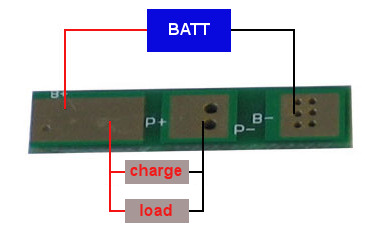

Originally Posted by zeropointbug
That labeling is horrible. Which diagrams are each person talking about? One is flipped around the other way.
The manufacturers diagram don't line up with the labels IMO. The big one is batt +, the one next to it is load +, and the far one is common ground... that's just the way I am reading it.
Even if it seems unconventional it makes sense to me that the larger size pad was made larger because it has to have 2 wires soldered on (B+ and P+), and that would leave the other two smaller pads to be single connections of B- and P- respecitvely.

Well, despite the diagram on the site showing one thing, I really disagree with you. Look at the labels, you are plugging the JST into two positives, does that make sense? Am I missing something?
I would agree that the large contact looks like it would be for TWO connections, but not according to the babels.

I believe my first couple diagrams, I screwed up completely, but the newer one, on Post #29:
http://www.rc-monster.com/forum/show...9&postcount=29
Make sense to me..
considering it's positive on one side, and has two common grounds?

You don't have two common grounds, the whole sense of the term is "common", is exactly that, it is common to both source and load.
The only explanation is that the labeling is wrong, or the diagram they show with the product is wrong.

Here...
It's wired up so that the charger charges the battery without the charge current entering the device, and so that the device is powered by the battery current, not the charge current. All this time it is monitoring the charge and discharge cut-off voltages.

05.17.2010, 12:17 AM
...Do we need Brian in here for an opinion?
lol, I saw the opening post and thought the device Neil posted was pretty straightforward.
In looking at the pic below, it should be pretty obvious that the battery + and load + are common.

05.17.2010, 12:23 AM
Chad, I'm not seeing like that at all. I see it as the lipo + and charger/load + are connected to the large pad on the right. The lipo - is connected to the pad on the left. And the charger/load is connected to the middle pad. Essentially, the LVC just disconnects the - lead if an error occurs.
Which would mean there are two grounds?
@Chadworkz: I thought the module would be supposed to be separate from th charger device, as in only the lipo, module, and a connector (for charging AND connecting to the device, but not at the same time)
05.17.2010, 12:39 AM
Two grounds? I think we are all making this a WHOLE lot more complex than it is. See the pic below.
They probably made it like this so that the "charger" also powers the circuit when it is plugged in, kinda like a laptop or whatever.
If the LiPo and Device positives are connected to the same pad, the LiPo will directly power the Device without passing through the Protection circuitry.

Actually, we need to wait until we see the actual instructions for this.
