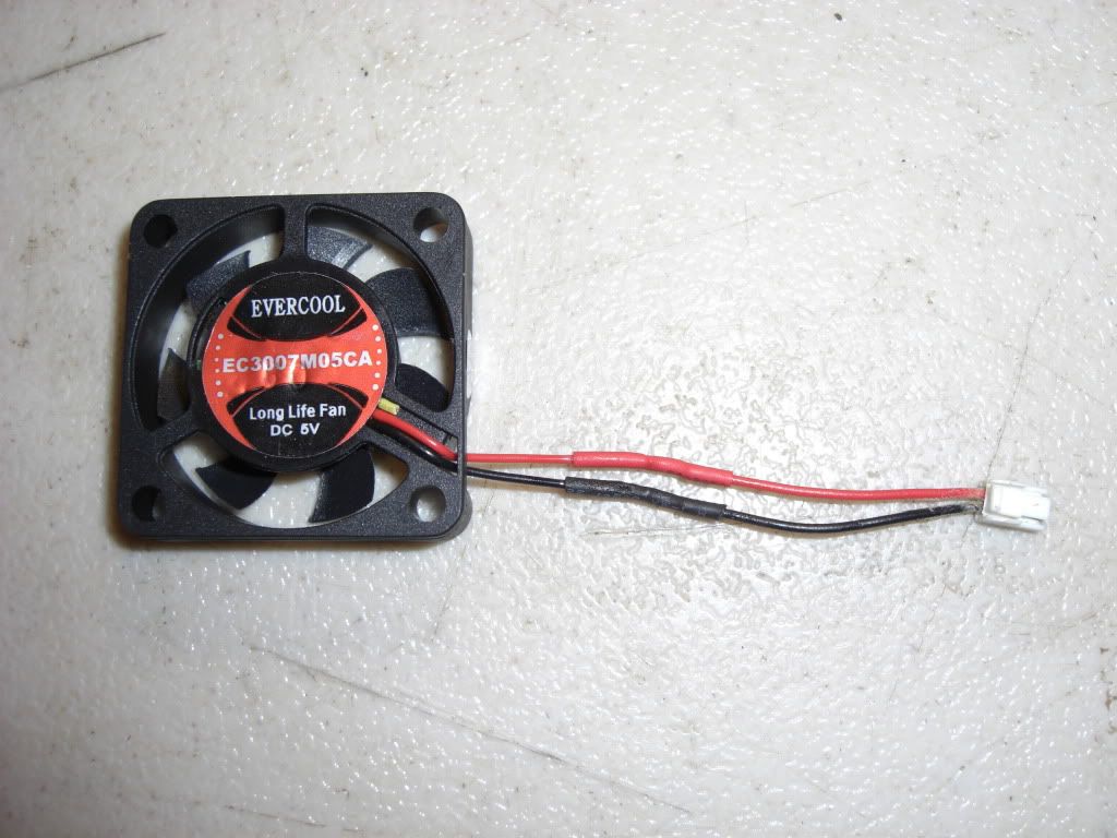

Had to open my newest MMM this morning to replace the fan (imagine that) and I see that the board is green but the components don't look the same as the pics of the v5. So it must still be just a later v3...with a new Evercool fan when I'm finished
Anyway here's a pic.
New fan ready to install

I like where it says Long Life Fan. Sounds like a challenge!
True story! But on my older MMM (3yrs) I have five race days and a couple of practice sessions on the evercool and it is holding up well. The reason I went with these fans is because my racing bud has had one in his MMM for two seasons and it"s still working perfectly and he isn't easy on a buggy!
Yes, notice your BEC board is still blue even though the rest of the power board is green. The v5 has green BEC and power board.

AHHH! I see that now.
