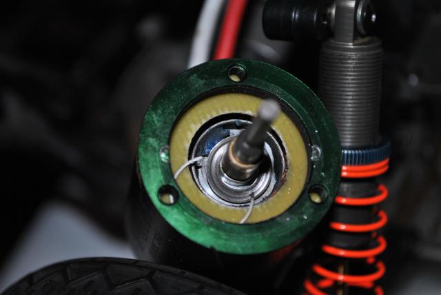

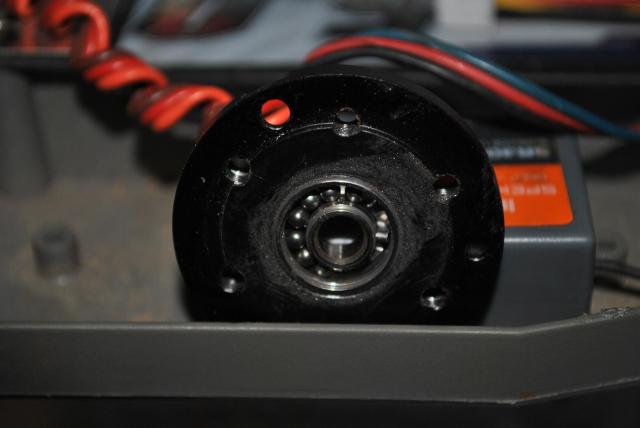

wow this came as a huge suprise to me today. This would be the third thing i had break in a couple days counting the fridge, my thumbwheel on my dx3s and now my beloved 1406 has jumped on board and decided to give me s#!% too. This being the only of the three i couldnt fix is whats pissing me off. This thing has ran like a raped ape from day one but today I switched the rash over to my dx3s and was setting the endpoints and what not, calibrated the speedo an picked the truck up to see how the startup was with and without load. Motor was making horrible noises so i shut her down right away. upon further inspection a found the rotor very tough to turn so i opened her up and this is what i found inside(see pics). The center race and the cage and all dropped out after i took the photos and now the outer race is stuck in the motor endcap. CRAP!! Havent checked but does castle sell rebuilds for the 14xx line yet? or will the cm-36 style rebuild work?

Eep, that's some bad bearing failure right there. That kind of thing really shouldn't happen; but unfortunately when you build enough of anything, there are bound to be defects. What Kv was this and what battery were you using it with? I think they might be the same endbell/bearing combination, or if they're not the same they may still be interchangeable; but I'd have to wait until I'm back in the office to do some measuring.
Strangely some retail sites are listing the 36mm rebuild kits as discontinued and they are not on our website either. This is news to me, so I'll have to look into what is going on when I get back in the office as well. Hopefully we'll be in tomorrow, but it really depends on how much more snow we get and how well they can get the roads cleared. I'll let you know as soon as I can. Thanks!

Cool thanks Thomas. It was a 4600 on 2s. Same motor and batt setup as in the first post on this thread but it's been in my 2wheel for the last month or two. Was kinda strange too, raced it on Friday night and all was good. Let it sit until I screwed with it today and it gave out. Better than it doing it flying down the track though!
