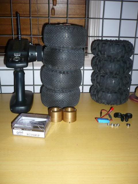

Got some more parts the other day.
Also got the very first custom made part for this rig done. A special spring retainer so you can use mini T fronts on scx10 shocks. The rod end cup is just off a set of HPI firestorm shocks that has had the outer lip sanded of. Before and after.

The foams are about 1 and a 1/4 rover foams and a 1.9 CI foam all stuffed in. Nothing fancy and I just put it in there really cause I don't have anything else at the moment. I will probably pick up some new CI foams down the track to try out, but we'll see how this go. Sorry I didn't get any weights as it seems the scales have gone walkabout Oh and finally BCs don't make for easy mounting on these wheels, it took me about 10 tries before I perfected the method
