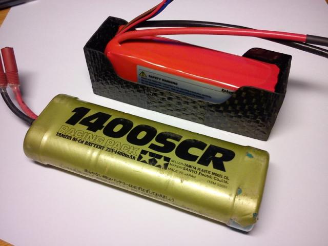

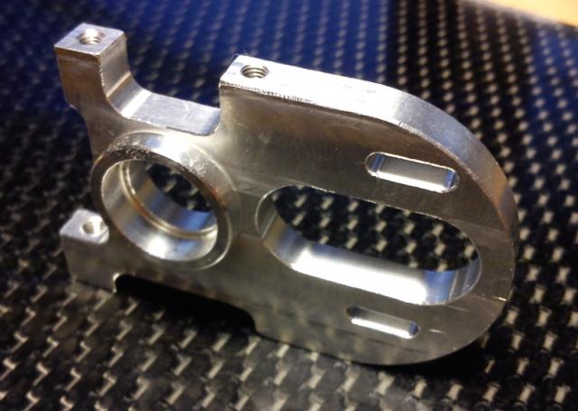

Attached are pictures of my self-designed aluminium motor mount and self-made carbon prepreg battery holder.
Regards
Thomas

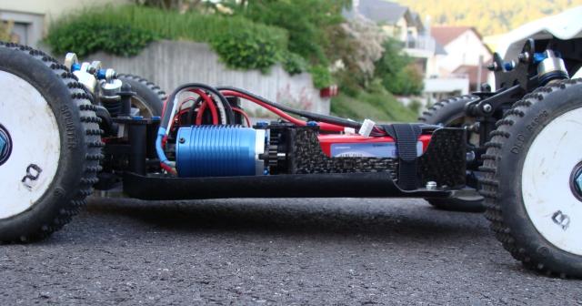

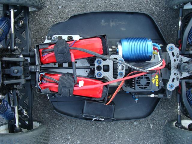

I thought this thread needs some more pictures. Here she is just before the shakedown today:
ID:	9972   Click image for larger version
ID:	9973   Click image for larger version
Regards
Thomas

05.26.2011, 04:23 AM
Hi Thomas
Yes of course, here you go.
Buggy: Very old TTR S3 EB4 with an aftermarket flat chassis plate
Motor: Tekno Neu 1509/2y/f (1820 kV)
ESC: Mamba Max Pro
Batteries: 2x 3s1p (-> 6s1p) Kokam 2400 mAh 30C
I will probably switch this powertrain over to a new buggy next year (if it works well). Will have to see which one fits the layout, or make my own chassis plate.

Can you please tell me more about the carbon battery trays? You made them yourself? What was the process?
Thomas
Thomas's Avatar
Posts: 84
Join Date: Apr 2009
Location: Switzerland
05.26.2011, 05:19 PM
Hi
Yes, I made them myself, at the university where I study. I used carbon prepreg, in this case twill with roughly 200 gsm. For the battery trays, I used a positive mould (plug) made of wood, which I simply cut to the size of the batteries plus some additional space. I used release film and laid three layers of prepreg onto the mould. Then I put them in a vacuum bag and into the autoclave at 2 bar pressure and 130°C to cure for two hours.
One battery tray (without velcro strap and double-sided tape) weighs 25 g. The carbon stripes for mounting with screws are glued on.
I will try to go to the race track tomorrow, to find out the runtime, but the weather is a bit unsure.
Regards
Thomas
