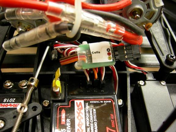

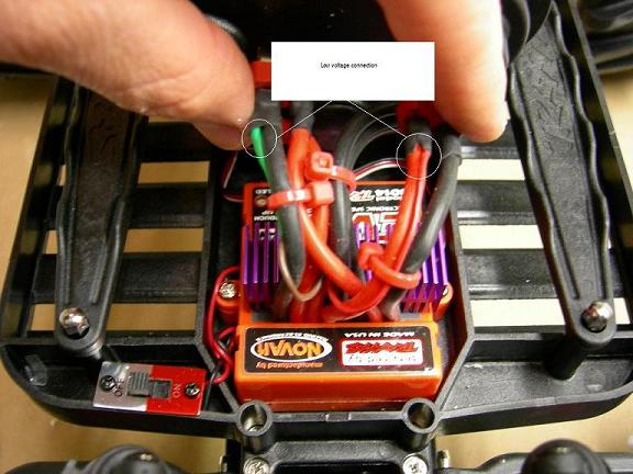

Here is what I came up with. I cut off the stock tamiya connectors and used the deans ultra. Kinda tough to solder them on as the wires from the esc are so short. To lazy to take the esc outta the truck.
The big question is do I have it hooked up correct??
(The green part on the wire is some heatshrink as I boogered the case of that thin wire a bit.)

Sylvester
Sylvester's Avatar
Posts: 3,493
Location: Canada
01.07.2007, 04:32 PM
Looks good! You've got everything wired correctly.
