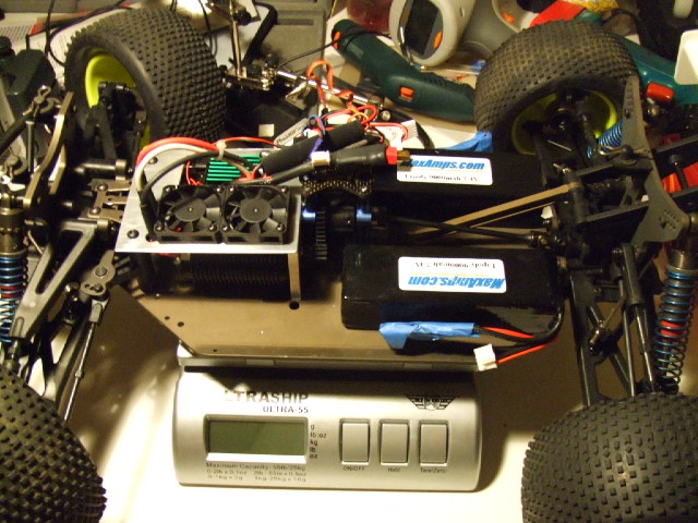

Layout wise I found in my CRT conv everything fit and was ballanced running the 1515 motor forward and duel packs in the back? pic 1
On my CRT.5 conv I tied the motor mount into the battery mount that runs from the front of the chassis to the rear pic 2 I found this eliminated just about all the chassis flex and made the car alot more stable at speed vers a friends CRT.5 with a std motor mount? If you can incorporate a mount like this in the XTM with it's exessive chassis flex it will help keep the car going in a straight line at speed.
Weight? get rid of as much weight as you can my CRT weighs in at just a little over 11lbs RTR with 2 8000mah packs you should be able to come in under 13-14lbs RTR?
