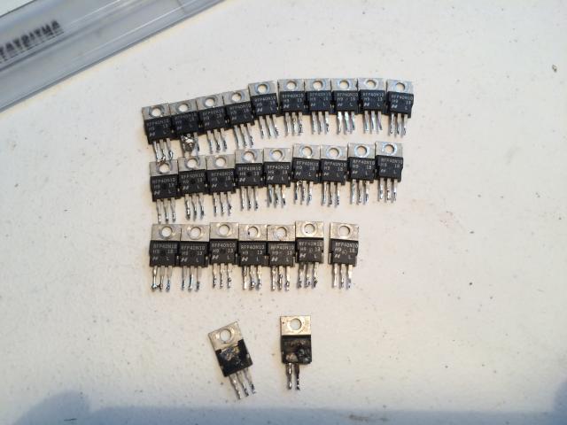

-no pictures on how to remove FET's - sorry
but here they are:
NEXT step - to Find replacement for 1998 FET - I selected IRFB4410ZPBF MOSFET N-Ch 100V 97A TO-220 -> close enough - better part - cost/availability - 28 fets
Note: replace them all with the same part!
