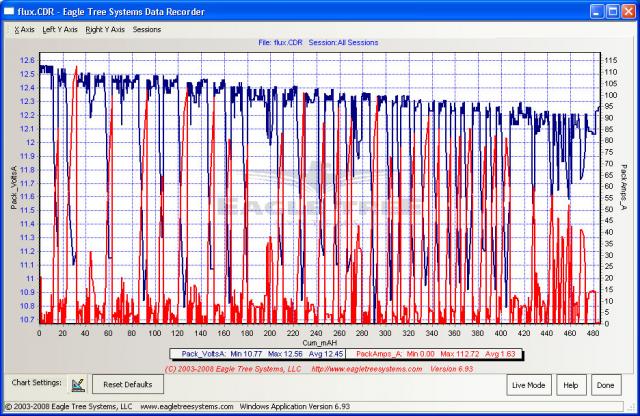

I'm running 2 3s 5000mah 20C/30C turnigy packs on my flux with a 20T pinion.
I have toned down the settings and throttle curve on the ESC.
100% punch control
lowest motor timing
reduced throttle curve
I wanted to see if the packs can keep up with the flux and prevent cooking the ESC. I hooked up the logger on one of the packs. I did a few standing backflips to see what kind of current is drawn.
To me, it appears i'm close to the limit of the pack, with one peak at 100a and voltage drop at 10.77. Is the rule of thumb, to keep it above 3v per cell at the C rating?
Can you guys tell me your interpretation of the log?
Thanks!
