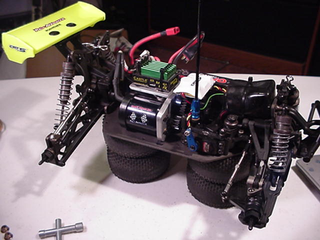

Well here's an update after about a month running the Neu 1506 motor with the MM esc there has been no sign of the dreaded cogging issue.:cool:
Runtimes have been around 30min vers 20-25min with the 5700 MM with the 3s 4000ma pack.
Power the Neu motor is alot smoother and has more torque then the 5700 MM although the 5700 is a little faster the Neu accelerates quicker.:005:
Temps the Neu runs cooler around 130-50's compared to the 5700 at 150-70's. ESC temps with both motors is around 130-60's depending on outside temp and gear's. Battery temps have came down with the Neu motor to around 105-110deg the 5700 MM with the 3s 4000mah Maxamps pack got up to around 130 and melted the shrink wrap on the end of the pack a little running a larger pinion and usually ran around 110-120 my guess is the MM 5700 needs a little more amp capacity the 4000mah Maxamps pack is rated at 80a C so a 100a 5000 pack would be a better choice with the MM motors.:032:

Thats good to know, I just got an 1107/2y NEU and will try it on my mini quake with mamba 25. Compared to lehner 1020, the difference in motors is like a 1940 to a 2250
