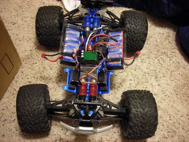

Originally Posted by rustnpede
I think i might try that. Edges with a bullnosed finish would be nice.
Yeah, here is mine as of now:
