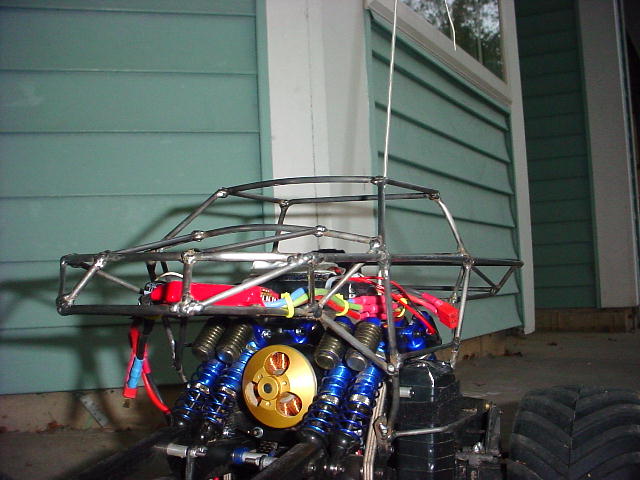

I'm going to start out with a Quark 80amp. To run 40+mph with this setup, I need to spin the motor at 7500rpm. That's going to require 6 Series Lipo. I'll try it on different battery setups. I see myself probably settling on 6S2P A123 packs, but I have alot of other Battery possibilites.
The battery trays that I'm building are rather large to give me plenty of room for ample batteries. The Battery "Area's" will be about 2 1/4" x 2" tall x 7" long. I can easily fit 10S1P A123 in there or a number of other Lipo configurations. I'm looking at other ESC options now though. I want a high voltage car controller that gets along with outrunner motors.
The old redcat is sitting on the shelf. I have the quark 65 in my ls10 running a hacker 13l at the moment on 5s lipo. Not too sure on the diff ratio, but it was 3:1 or 3.25:1, something like that. I ended up using the new traxxas bandit anacondas on hpi wheels to get the gearing right. It was driveable on 4s and ran nicely. I may get some sort of nitro shaft driven on road car and try it out with a mm on 4s. Not sure how the MM will do on an outrunner, but we will see. I may post a thread asking if anyone has a tc they want to let go cheap, maybe a ntc3 or some sort of flat chassis shaft drive vehicle.

Sorry to pop your bubble Linc, but the MM does NOT like outrunners at all. It has something to do with their software OR their switching rate. You can try it, but it won't work. Cogging.........Cogging.......confusion..........C ogging........Thermal shut down was my experience.
It appears to me that the Kontronik line of controllers work well with the outrunners. Judging from what I've read and seen in the forums.
