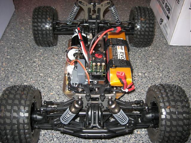

You did a great job with you battery tray...you should sell those. I ended up using the Tekno RC Revo battery tray on my CRT.5 EXT Chassis. I got lucky because the bolt pattern matched up perfectly.

Sorry...I don't mean to hijack your thread...back to your original topic-BL system for CRT.5. I will say this...the Neu 1509 1.5D and MMax ESC work great together. I was concerned I was going to have problems similar to when I tried the MMax with my 1515 motors...but not this time. Zero cogging with 15/46 gearing...temps are okay too...but it is cold outside so I guess it is hard to say.

Here's the bottom...I just used two screws to mount the tray and added Velcro to the inside bottom of the tray and botom of the battery (adds some cushion and keeps it all together). The bolt pattern with the tekno tray was a perfect match on the ext chassis.
