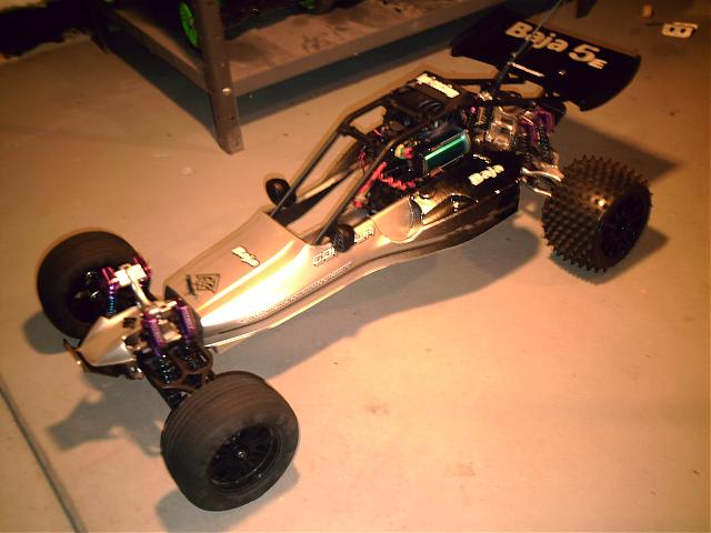

8S KB45-11Xl would power that thing without a problem... I powered my 15Lbs with a 12Xl also.... you would only need one motor... that looks killer... a lot better than my attempt at the 1/5th scale... :)
Maybe some bigger wheels would make it look even better....
Great work dude..

I wish I could get a video but as you can see by the pics I don't even have a decent camera. I've pretty much completed it. I set it on the scale and it weighs 13lbs exactly, rtr. I have ran it a few times and can say that I am more than happy with the buggy itself. It handles amazingly and has perfect front to rear balance. I was worried about the turn radius with such a long vehicle but it turns very well. I do need thicker oil in the rear shocks and I and I am going to order a larger pinion. I am under geared running 14/66 32p gears. I hooked the eagletree up for a run and got a max 1492 watts with a max 89 amps. I'm running a 9xl with 6s2p a123 and I get about 20-25 mins of hard running. I defiantly want a better more efficient motor and to run a HV setup.
