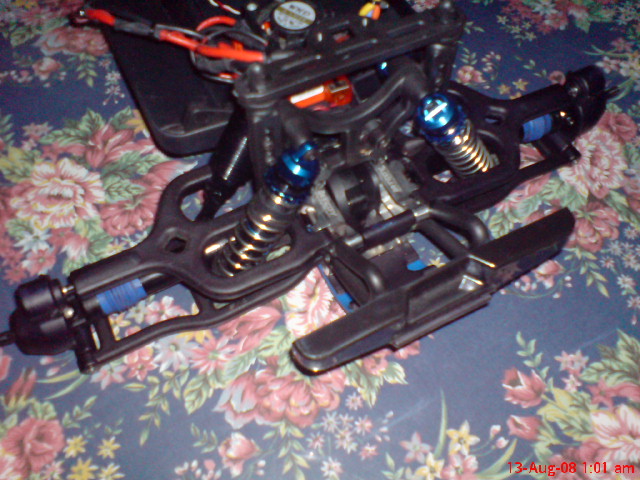

The losi shock springs will rub on the tmaxx arms. I tried this setup and it didn't work well. It will only work for single arm suspension arms like the flextek, Dace, and Gorillamaxx.
Here are the info I have gathered on the UE/Ofna and Losi 8T shocks.
UE/Ofna:
Shock shaft Length - 58.73mm
Shock shaft Diameter: 3.6mm
Length of body - 55.5mm
Diameter of body - 13.5mm
Length of springs - 79.5mm
Losi 8ight (rear shock):
Shock shaft Length - 57mm
Shock shaft Diameter - 4mm
Length of body - 50.5mm
Diameter of body - 15mm
Length of springs - 78.74mm
As you can see, I forgot to take into account the spring and spring retainer diameter.
