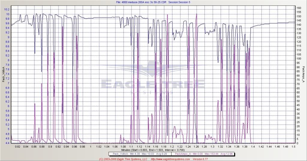

I hooked up the 4800kv Medusa onto the Rustler with the heavy beadlocks and Imex tires. With the use of a cold 3s1p A123, 200A ESC, 58/25 gearing, it pulled my voltage down to 4.39V@153A, peak 786W. I'll drive it around through grass tomorrow and see how the motor and esc behave.

Nice. Did you have any stuttering issues? How was the start ups? I asked the factory to do their best for the ESC to work good in sensorless mode with 4 pole and higher motors and they're waiting for some info. I told them I tested my Neu 1515/1.5Y with 4S unloaded and it didn't have any issues.

Did another run w/3s2p A123 and peaked it at 182A@5.88V with a peak of 1204Watts. In 4 minutes I consumed 1400mah.
The ESC is really smooth with the medusa. No cogging whatsoever.

Nice. The ESC is sure putting out a lot of power. Almost at its peak. It'll be nice to see someone that has a Tekin RS Pro try the same thing. I wish the weather was better here so I can do some runs as well. I guess me buggin' them to make sure the ESC will work good with a multi pole motor paid off .
