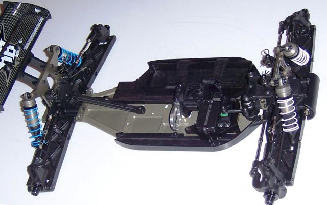

d8 teaser - 11.28.2009, 01:32 AM
The top plate isn't shown, but it looks just like the one on my RC8 conversion(but thicker to capture the bosses on the D8 CD bulks). :)
Name:	d8T conversiont2.jpg

11.28.2009, 09:05 AM
WOW, very cool stuff Mike! I will definitely want the receiver box and servo mount

I actually made a custom aluminum top plate for the D8 to allow use of the Slipperential. I also made a custom radio box and battery tray for a complete conversion - as soon as I can get a few through production, I will list them in the store.
