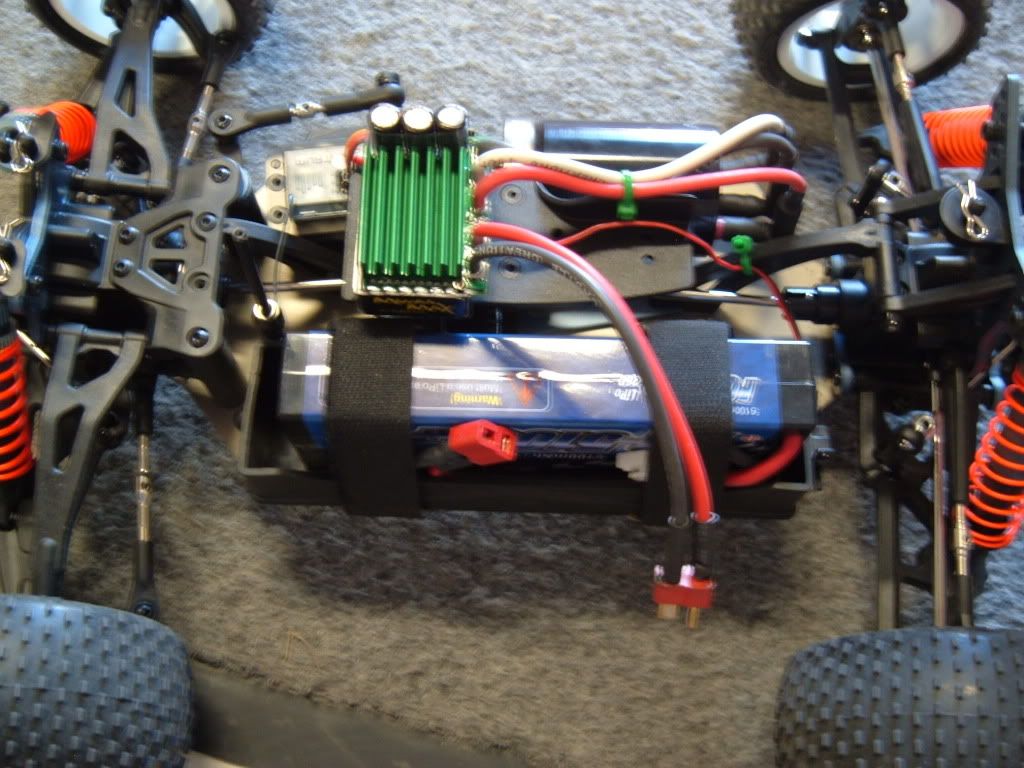

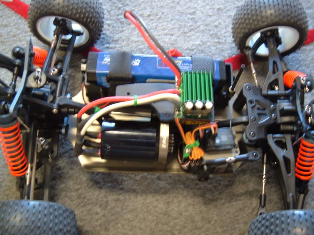

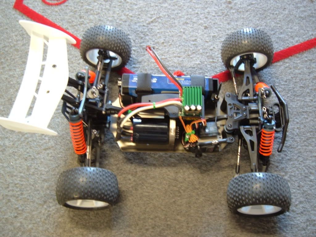

I will run a 1509 1.5d with a MM on 2s lipo. I have some pq hardcase 5100 25c 2s lipos that fit nicely. Gearing with a 16t pinion seems to be about spot on, my batt was not charged, so I will throw it on the charger tomorrow and see how it does.
Gave it a spin just now and the cd unloads bad, thinking some 10k in there will do the trick. Feels like it has 0k right now... I may try 7k first, just to see the difference. Otherwise it handled well and seems to tun and track well. Definitely a track truck, not enough ground clearance to bash on my usual areas (grass and ditches), but they are more suited for a MT anyways.
And here are your pics, the coloring book is in the mail for you...
