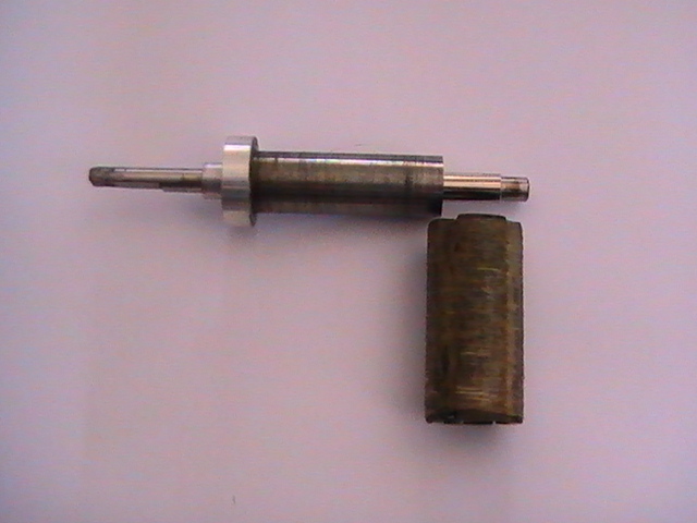

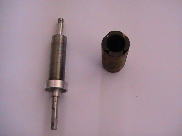

Yep my new rotor's just gone as well, 2nd time out total of about 27mins running, not even racing yet, just taking it (relatively) gently, have e-mailed Tekin, hopefully they are as good as everyone says.
email takes 48hrs+ call them tomarow and you should have a new rotor before next weekend
