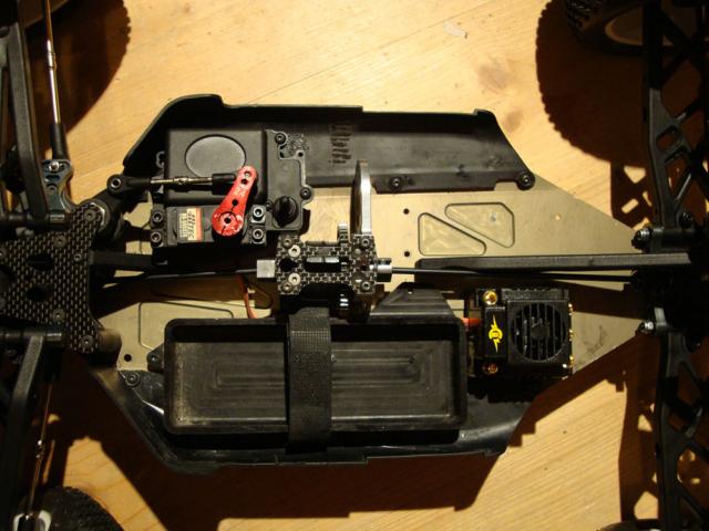

would there be anywhere a plastic spur gear avaiable?
a 46 plastic spur gear for the mugen mbx6/T center diff?
mihael
No, But you can build a compleate AE RC8 center diff with a plastic spur & it will fit into the stock Mugen center diff mount. I've also used a compleate Kyosho Inferno center diff with Kyosho plastic spur but this is about 2mm to long to fit into the stock mugen mounts so mods are required.
