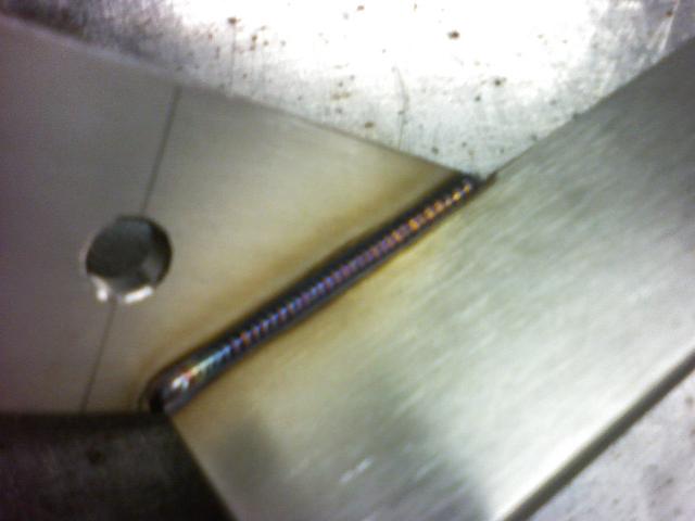

J57ltr
Posts: 610
02.14.2011, 12:38 AM
For something that small you are going to want TIG, You also want to use argon and sst welding wire. If you use standard mig wire it will be weak as all get out. Mig is fine for large materiat and structure, but for fine work it sucks. Stainless is very strong even getting a tack broken loose is a pain. Stainless will move on you as well. It warps easily if you are not used to working with it. If you need I could weld you up anything you need in sst. I do everything from 20 gauge sheet metal to 3/8" 100% through welds.
Jeff
