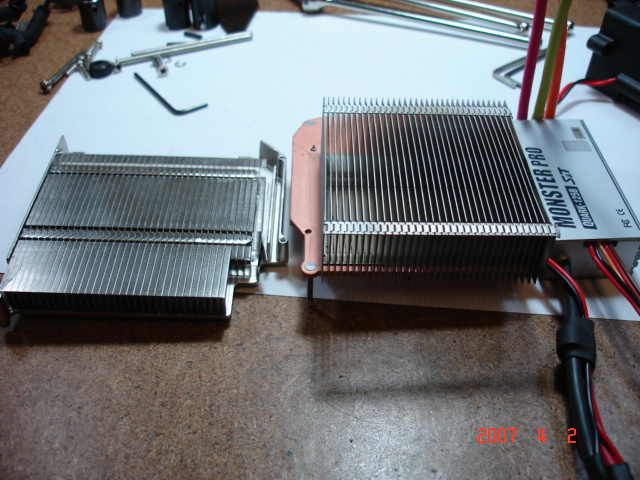

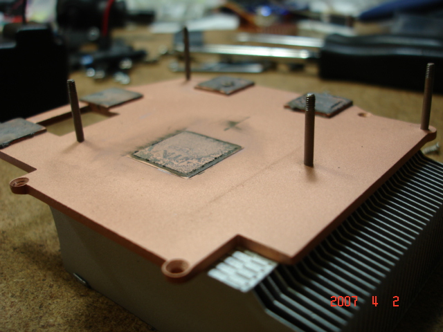

I don't know which one to use yet, the big one will sure keep it at a very low temp, you could prob run the La Mans 24 hour race!
Large one: 220 grams
Small one: 66 grams
Both will weight less once finished, as i have to remove some heat spreader, and lap them both.

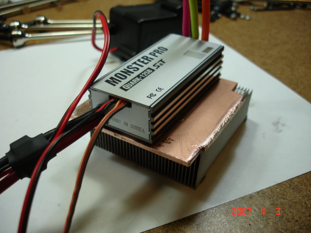

There, I ground down all the excess copper heat spreader around it, and the pad fits the Quark perfect both orientations. It now weights 140 grams.
All i have to do now is go and buy some 600 grit sand paper and lap the thing until it's perfectly flat.

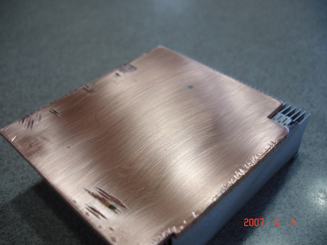

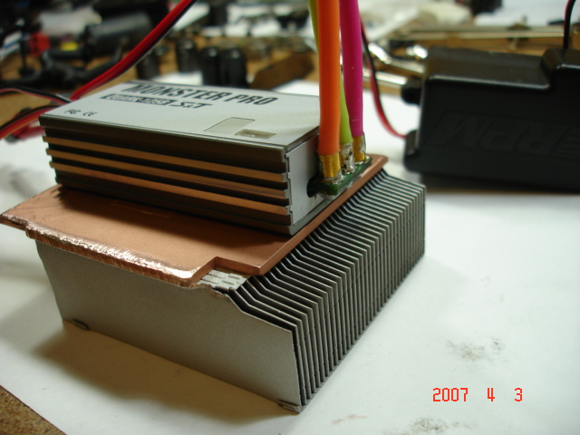

I just finished lapping the heatsink. Dang it was hard work, i went too deep with the grinder beforehand, the sanding could not remove the marks.

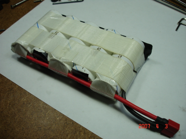

I also got my shrink wrap in for my packs.

04.03.2007, 08:35 PM
Awww man, that's not lapping! You should be able to see your reflection like it was a mirror when you're done! ;) That's one big heatsink! You gonna mount the front and rear suspension directly to it? ;)

LOL, i was planning on using it as a bulkhead!
I know, i know, not the best lap job i've done, but that's the best that 600 grit will get you! PLus, the grinder scares could not be removed.
The Quark sits very flat on it now, in fact, if I put a drop of water on it and put it on glass, it takes quite a bit of force to remove it. Which is a good sign of flatness, and smoothness. All I have to do now is get a copper pad (what was it 3mm?) for inside the Quark.
