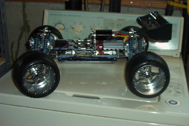

Pictures are a few years old, but the truck is in exactly the same condition, save for some dust. I never even painted the body - the truck looked so good, paint would hide it. :)
This truck has RDLogics wheels on it, GorillaMaxx chassis with a custom rear upper deck that integrated a heat sink for the Quark ESC(which is also modified with a couple ounces of extra copper inside). Also has the original Slipperential transmission installed. :)
This truck was basically modelled after my race truck, but not quite as spec'd out(has Hybrid bulks, while my race truck has UE towerless bulks, etc.).

Monster mike > That's seriously good looking. Those RD Logics wheels are badaxx! Are they true bead loc wheels or just look alikes?
  (#30)
RC-Monster Mike
Site Owner
RC-Monster Mike's Avatar
Posts: 4,915
Join Date: Nov 2004
Location: PA
01.16.2012, 04:45 PM
The RDL wheels, while nice, are not true beadlocks. They have interchangeable centers, which were available in different colors and styles - they were less than $200 for the full set, too if I remember correctly. I don't think they are available any more and I don't have those particular rims myself anymore, either. :(
