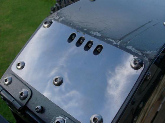

Ah yes I know what you mean Brian, my roof was pristine until last night when I put it on it's lid and skated it about 40 feet on the pavement..... ouch!
