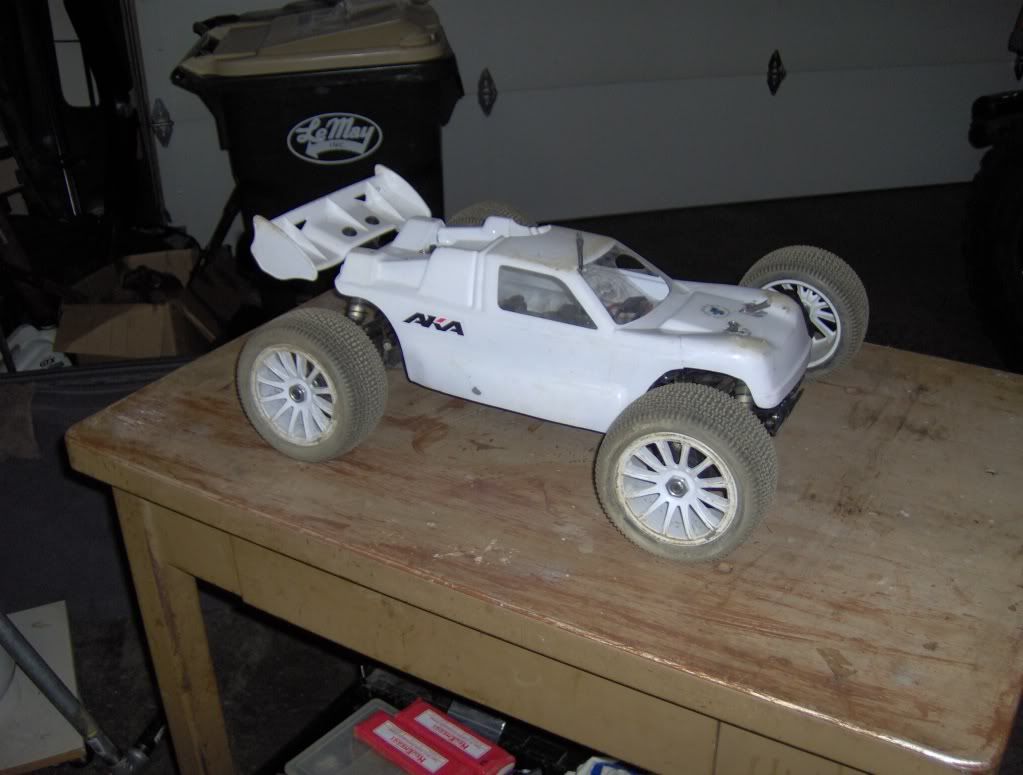

New lid, SHIFT for 6T. I want a 6T badly, but until I get one I'll keep tinkering with this bad mamba jamba
old, stock body-
SHIFT
Gotta put the decals and stuff on, but it looks pretty good to me. Nice and simply, lovin the white scheme.
