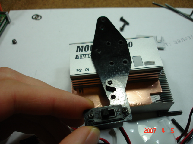

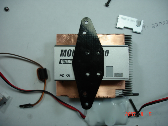

Here is pic of the CF piece i think i'll use for putting pressure down on the Quark to the heatsink surface.
ID:	2705   Click image for larger version

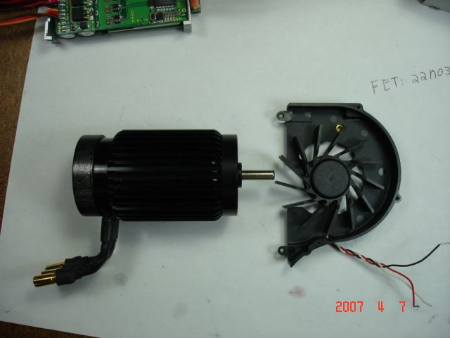

Also, I was looking at one of the fans that came off one of the GPU heatsinks. It;s small, very flat, and blows alot, ALOT for it's size.
I am just trying to figure out an efficient way of using it to cool my 7XL. I was thinking of using a shroud (don't know from where, or what :032: ) so it channels the air over the entire circumference of the motor heatsink.
It's a 12 volt fan, and uses 3.3watts, as confirmed with my power supply.
EDIT: I would take the rest of the frame off the fan to mount it.

I just read through this thread and it just dawned on me that I saw a reference to arctic silver. If you are going to be using that stuff on the inside of the case, I wouldn't. Although it isn't supposed to be electrically conductive, I think that a matter for some debate. In any case arctic silver does exhibit signs of capcitance. Like I said, I'm not real swift on these sorts of things, but to me, capacitance or conductor, I wouldn't go wiping that stuff all over my expensive electrical equipment. I'd use Arctic Alumina.
As for the sink, it looks neat, but where are you going to put it. I have had experience with dealing with heat when messing with LED lighting. LEDs get VERY inefficient when you drive them hard and they produce a lot of heat.
Anyway, I've found that there are two ways to get rid of heat. Or move it to another place. The first is to use a big heat sink. What I mean by big, is mass. Say two to four ounces of aluminum. The other way is to increase surface area to promote convection and we do this through the use of fans. The problem with this is that air is a very poor conductor of heat. You have to move a LOT of air for it to be effective. The way that we are using fans is to make up for the use of small heat sinks.
Not to get off on a tangent or anything, but I'm bored, so here I go. You could do a little experiment. Take a piece of metal, like a 5.5mm connector. Hold it up with something that doesn't conduct heat very well, like a clothes pin and then hold it over a cigarette lighter (lit of course, LOL) for about 30 seconds. Get it good and hot and then blow on it and see how long it takes to cool to a point that you can hold it in your hand. Now, do this again, but instead of using a fan, just set the connector down on it's end to get good contact on a thick piece of aluminum or even steel and then see how long it takes before you can hold it. I'll bet that it will cool faster by just setting it down on the "sink" than it does by blowing on it.
Anyway, I like the heat sink that you are making. It looks cool, but if you want a heat sink that big with a lot of surface area, why don't you just mount it to the chassis?

Also, AAngel, teh Arctic Silver thermal adhesive is non-conductive, and SLIGHTLY capacitive. I will take care applying this though, I am going to apply a thin layer onto the heatspreader, and then apply it to the FET's. And then I will do this again to attach it to teh Quark case. Then I will use regular Arctic Silver thermal paste between the case and the big @$$ heatsink.
About the heatsink, it is designed for very low airflow rates, the stock fan that came with it was only 17cfm or something near that. The airflow that it will see in action on a truck will be far greater than this. Not that I would need airflow anyways, it would do a VERY good job without it even.

I still don't get it. The sink obviously doesn't have any mass, so it can't pull much heat away from the esc before it gets to be as hot as the esc is. It has to rely on dissipating the heat into the air around the fins and then getting that hot air out and cool air in to repeat the process. I don't see how you can say that the sink will work without fans. So, this thin aluminum has all of these fins with the purpose of moving the heat from the sink to the air around the fins. So what happens when the air around the fins is the same temp as the sink itself and there's no fan to get the hot air out and cool air in. You have to move the air, because, as I said, air is a horrible heat conductor. The hot air isn't going to pass its heat off to the air around it.
I also don't know how you can say that the sink effectively dissipated that much heat with very little air flow. I'm going to assume that you are talking about the sink being inside of a computer case. If that is true, you can't say that there isn't a lot of air flow. Not only are fans in computer cases designed to move air, but they are placed inside the cases in places where they will be the most effective.
I'm also not getting your mentioning more fins working better with higher airflow and fewer fins working better with lower air flow. I can understand that if you have a given area with say 10 fins, you have to have a higher pressure air flow to cool it than the same area with 5 fins. It's kind of like flowing water through a pipe. With a 1" diameter pipe, you'd have to have a higher pressure/flow to move X amount of water in a given time than you would with a 2" diameter pipe. The larger pipe can flow the same amount of water at less pressure, but it is none the less moving the same amount of water. In this case, since you have lots of fins, the pressure of the air going through the fins is going to be higher than it would be if your sink had fewer fins. Are you saying that your sink is going to work better in this case with little air flow. If so, I'm not following.
I'm not trying to be argumentative. I'm must hoping to learn something.
It still seems to me that attaching the esc to the chassis is the best way to keep it cool. Lots of surface area, inspite of the lack of fins, and lots of mass to store heat until it can be dissipated. I wonder how long it would take an esc to heat a chassis up to 160 degrees F.
