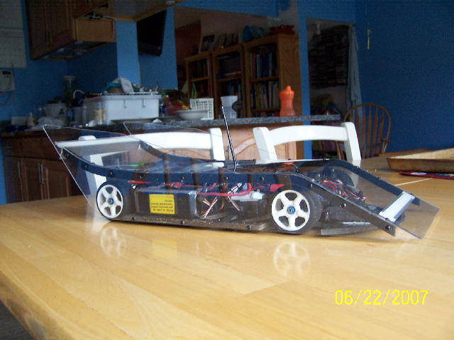

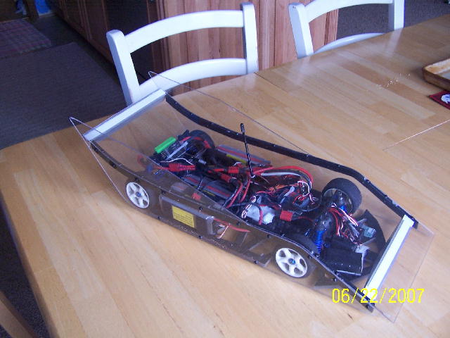

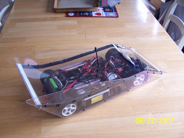

Here is a picture of my 1/16 inch thick lexan body. It works great (alot better than it looks).
Matt

  (#53)
What's_nitro?
Soldermaster Extraordinaire
What's_nitro?'s Avatar
Posts: 4,529
Location: Plymouth, MA, USA
03.31.2008, 08:46 PM
That's so sweet! But you have 1/64" too much ground clearance.
What did you use for the "rails" inside the body?

Originally Posted by Revracer View Post
mod man is that the record tc3?
No, its my TC4. This is my CF top speed car with a body I made for R&D.
The rails holding the panels together are 1/4 inch delrin strips.
Matt

03.31.2008, 09:18 PM
Originally Posted by Mod Man View Post
The rails holding the panels together are 1/4 inch delrin strips.Matt
Did you just hit them with a heat gun to bend them? I may try that to reinforce my GTP body.
  (#58)
Mod Man
Posts: 156
Join Date: Nov 2007
03.31.2008, 09:30 PM
No, they are made by cutting the profile with all curves out of a flat panel. There are three strips screwed together to give the final shape. It is heavy but strong.
Matt
