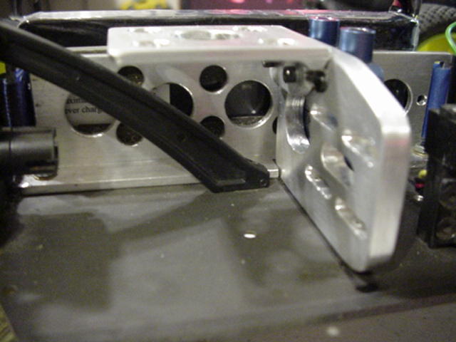

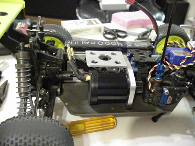

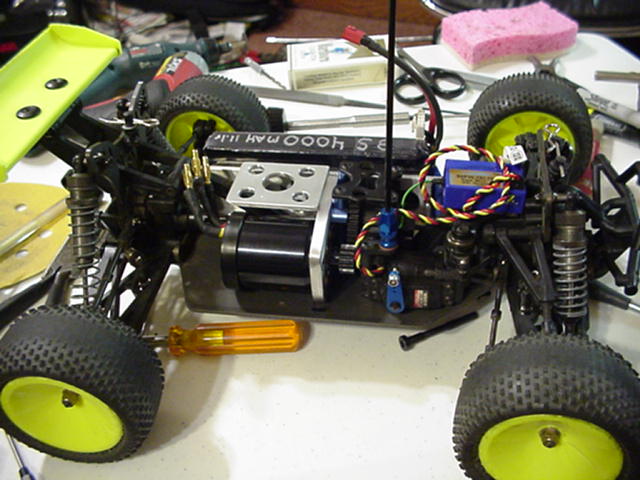

If your looking for a bolt in mount I would wait for Mike to get his mount and spur done if you want one now your going to have to redrill some holes in the chassis and use the Kyosho plastic spur see "Ricemans" post on doing this mod or find a hardened pinion? You can get the Mamba Max motor and ESC for around a 150 bucks I need to find that link?
http://www.pfmdistribution.com/secur...y.asp?catid=54
I found the weak spot in the front end today at my friends MX track jumping a 20ft dbl jump I broke a front camber turnbuckle I found a screw that fit and cut it down to get it going again and lawn darted it later and broke the C-hub and upper camber link.:002: If you dont want to be sidelined I would recomend getting some spare turnbuckles and plastic parts to be safe.:032:

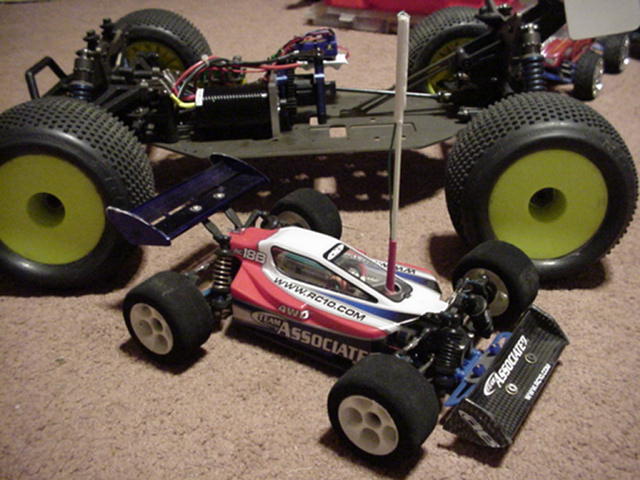

RC I do that with all my new cars take em out and see what breaks find the weak spots and fix em before I get to the track. The CRT.5 fly's great the balance is very neutral and the handling is very impresive with the battery mount and motor mount there is almost no chassis flex even the onroad handling is great. I'm thinking about picking up another one and basicly do the samething I did with my RC18B with a 4s or 5s lipo and a proper motor for a worlds fastest 1/12th scale RC car? :005:

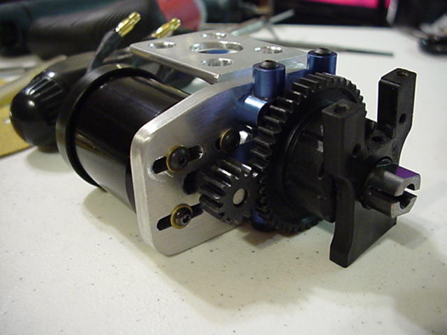

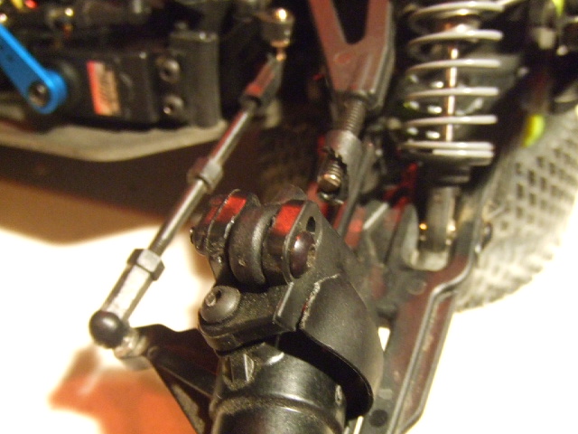

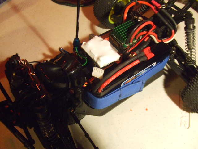

Well I got the Neu 1506-1Y today and got it mounted up in the CRT.5 hopefully the MM esc is going to work? see how it goes tomarrow keep my fingers crossed:013:
I snaped a shot of the motor and battery mount the blue aluminum diff mount is off my CRT with the buggy diff tubes it's 2 pc's and clamps the diff bearing so I can put the diff in and set the pinion & spur mesh with the motor and diff out of the chassis.:027:
I ordered some titanium turnbuckles from Lundsford they dont have a kit yet so I had to piece together my own here's the part numbers if your interested.:017:
#1009 3x20mm servo link
#1069 3mmx2" steering tie rods
#1072 3mmx2-3/8" rear camber link
#1029 4x23mm front upper arms the stock one is 3.5x24mm but lundsford does not have any 3.5mm turnbuckles so I went with the 4mm and im going to open the holes up a little it should be a little stronger I have already snaped a stock one. :dft012:

  (#75)
Procharged5.0
Procharged5.0's Avatar
Posts: 1,729
Location: Chicago, IL Area
05.23.2007, 10:05 AM
Looks good! I'm really interested to hear if your MM and 1506 work well together. Let us know!
