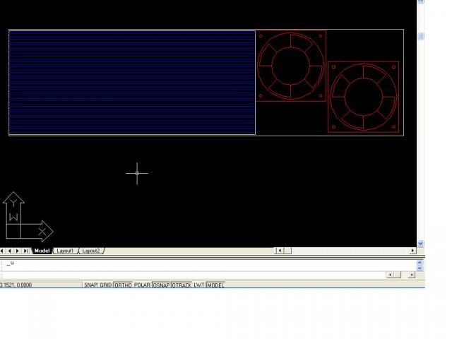

That's exactly how I have done my heatsinks and it works great I just used 1 at the end that was a 4 5/8" square fan thermister controlled (ended up just shorting it out because it just wouldn't run fast enough for the application). Mainly a fan at 1 end because it's easier to bend. I have a ACAD pic I drew up but I can't remember how to capture a screen shot(edit: nevermind). I have it setup with 2 fans on 1 end.
As far as constant current you must add in the more parrallel resistance in order to keep the current constant. You could use a window comparator to turn on a fet or relay to switch in more resistors. I have a line on some .001 or .01 ohm resistors that are like 100W or 75W same style but bigger.
Jeff

J57ltr
Posts: 610
08.05.2009, 12:27 PM
That's exactly how it's set up, for some reason the fins don't come out as dashed (hidden) lines. The resistors would mount on top fins down the shroud would be sitting on the table with fans where you want them. I can barely see the pic on my screen here at work, but the one at home looks OK. Access to the resistors would be on the top just like in the pic I posted earlier flat side up.
Jeff
