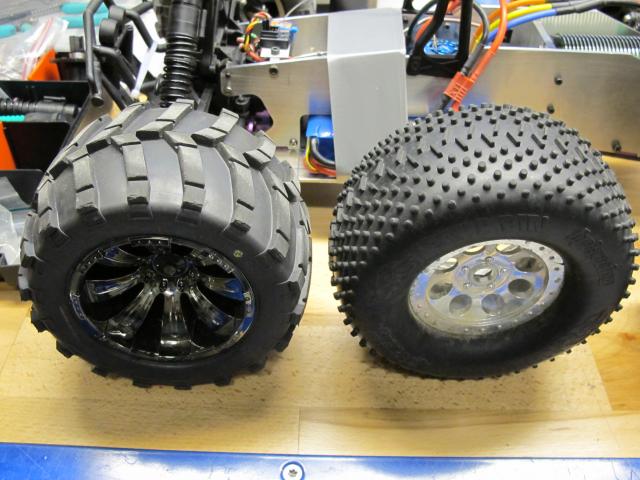

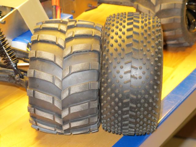

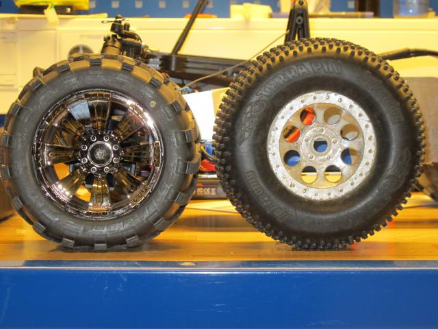

Wheels... better late than newer!

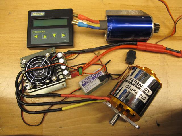

And things to come... now with the OK hobby 1/5th controller. Seems ok... havent tested it... just plugged motor in and seen it spin.
KB45 XL is there for size comparison. The ESC is somewhat large.
