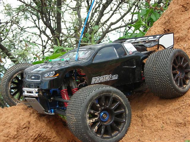

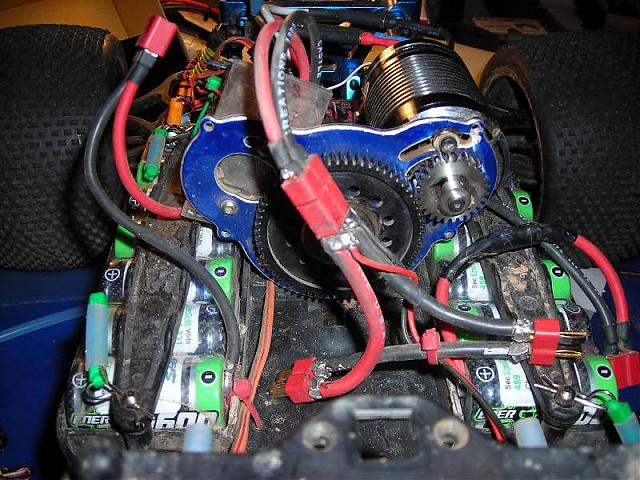

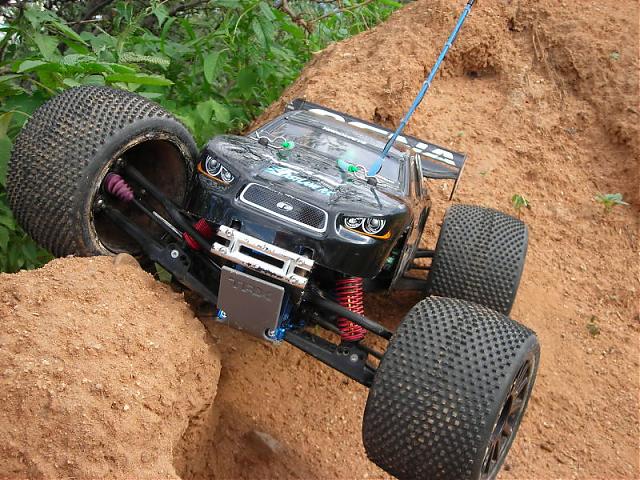

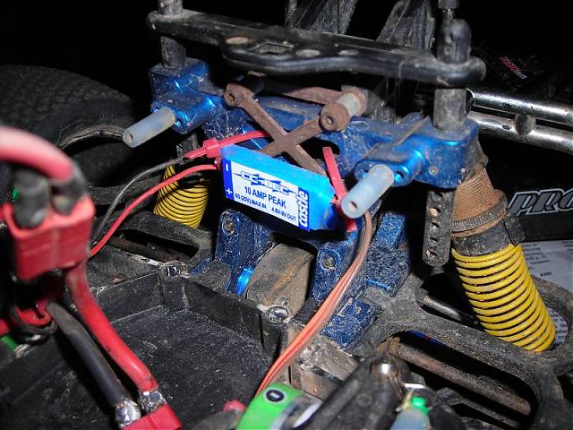

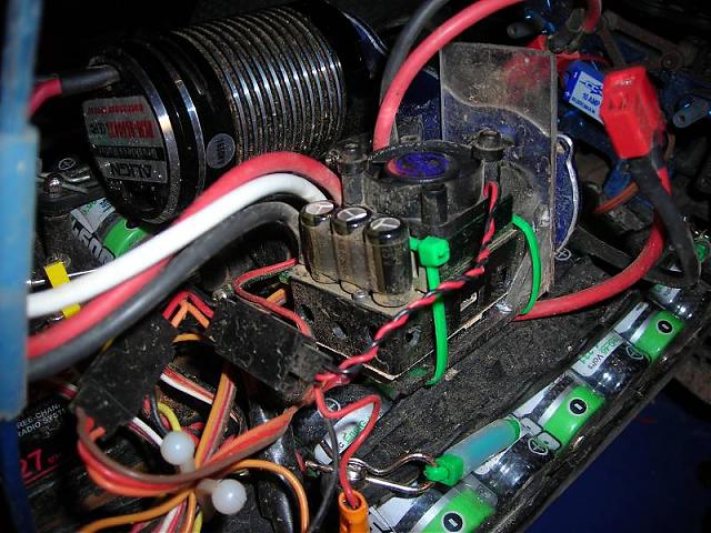

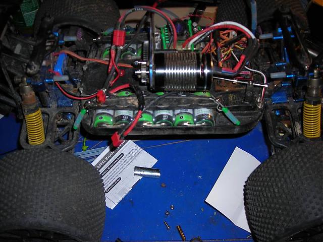

Well, here is my Maxx. Currently brushless, and the build of it continues.
Here is the current setup of the truck-
Aluminum Upgrades -
- GH Racing Aluminum Bulkheads (Front and Rear)
- GH Racing Aluminum Center Braces
- GH Racing Aluminum Shock Towers
- GH Racing Aluminum Steering Setup
- Duratrax Aluminum Servo Guard
- FLM Aluminum Diff Cups
Other Upgrades -
- 4 OFNA Ultra LX One front shocks (2 in front, 2 in the rear) (More durable, looks better, smoother)
- THS Racing CVD's
- Traxxas Center CVD's
- RC-Monster steel idler gears
- Hitec HS-645MG Steering Servo
- Futaba S3004 Shift Servo
- Proline 40 Series Wabash Wheels (Dyed Black)
- Proline 40 Series Crime Fighter Tires (M2 Compound)
- Proline 23mm wheels hexes
- Tekno RC Wing Mount with OFNA Hi-Downforce Wing (Black)
Brushless Setup -
- Mamba Max
- 25mm Novak Fan on the MM
- two 30mm Novak fans on the motor
- CC BEC
- Series Y Harness for 12 cell NiMH or 4S Lipo
- Align 600XL Motor (Gearing is 28/66)
Anyway, here are some pics of it as well. The first 5 pics are about a week old, I now have a dual fan setup on the motor, as well as RPM arms all around. And the last few pics are about 4 weeks old, when the truck was still brushed.

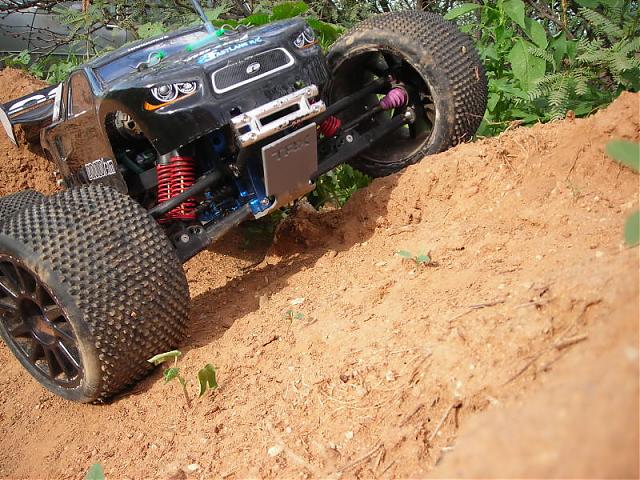

More pics

And since this is a build thread, I guess I should start posting updates about it.....
I have started putting a full set of RPM arms on the truck (its very tedious work too..... )
and I should get my new Protek 4000 mAh 2S 30C pack back from A-Main soon... I have one of the 2S packs still, but I had to send one of them back to A-Main because it came puffed in the mail. Should have it back by about Tuesday or Wednesday.
Also in desperate need of some of those UE SuperMaxx Dual Rate Springs, because they are the only ones I could find that came with stiffer rating on them. And UE says they are out of stock.....

09.12.2008, 11:42 PM
Ahhhh get some shrink or tape on that y connector you are asking for a short...
Krawlin
Got brushless?
Krawlin's Avatar
Posts: 592
09.12.2008, 11:44 PM
Already taken care of. Those pics of the brushless setup are about a week old, all of the bugs and small things like that have been fixed.
