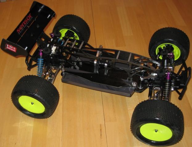

Heres some OLD pictures of my BPP LSP from when I bought it. It looks quite a bit different now.

Thanks for all the response!! Everything will be old school. The losi 2.0 will be old school in 3 years. Hey squee, I love the side battery boxes. What were they from? What about the cage? Where is that from? What does it look like now? I have a maxamps 6 cell 5000max lipo I would like to use for this conversion. The castle creations mamba 2200kv is too high right? I would need what a 1700 or under?
Its ALL carbon fiber. The chassis, and the cage. Its a Bombproof Products LSP kit. If I remember right they only made about 20 of them and they were right at $500 just for the chassis setup, then you had the buy the LSP itself. They only made a couple in carbon fiber. I've never seen another as a matter of fact.

So Squee, hoy have the worlds only full carbon LSP and yet
what the hell did you did you find to upgrade it with?
Thanks again for your help when I was converting my buggy.

Originally Posted by nativepaul View Post
So Squee, hoy have the worlds only full carbon LSP and yet what the hell did you did you find to upgrade it with?
Now its got 8mm axles, buggy 22* knuckles and upper arms, stainless and purple hardware, Dace CRT 23mm hubs, shock socks, aluminum shock ends, yellow high downforce wing, doubled up purple ackermans off a buggy, etc. Thats all I can think of right now, but I'm thinking of changing the shocks up to something adjustable, putting the purple aluminum shock towers on it off a buggy (with the way the center brace is I think I'll have to go with rear shock towers front and rear), 17mm purple hubs, and I've been thinking of going with the newer D8T suspension, along with a redesigned motor mount (and going with a 1717 ) that'll put it in the center, and getting Mike to make me some new battery trays, maybe in aluminum .
Oh, and I went with the buggy front bumper and no rear bumper, put the sway bar back on the rear, and a dark red metallic CRT body with a Upgrade RC graphics kit. I think thats about all the stuff I've done to it.
