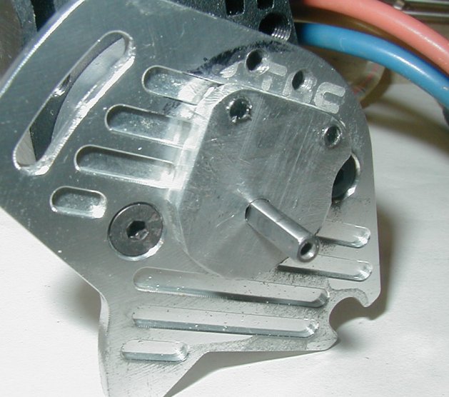

The 10.5 takes a 3/16X1/2" bearing. I have replaced some with McMaster-Carr part number 57155K374. I can't really tell you if they hold up better than the Novak bearings because since replacing them I have taken great care to prevent dust from getting to them:
I didn't have a bearing puller for a 3/16" I.D bearing so I improvised: An associated CVD axle into the bearing from the outside. A 1/4" drive 1/2" ID socket on the inside, a washer and 8-32 nut on the end of the CVD axle protruding from the socket. Heat the endbell with a heat gun to soften the adhesive (and expand the aluminum more than the steel, making the fit less tight) and turn the CVD axle into the nut to remove the bearing. You need to make sure the new one is pressed in with the axis exactly perpendicular to the endbell.
