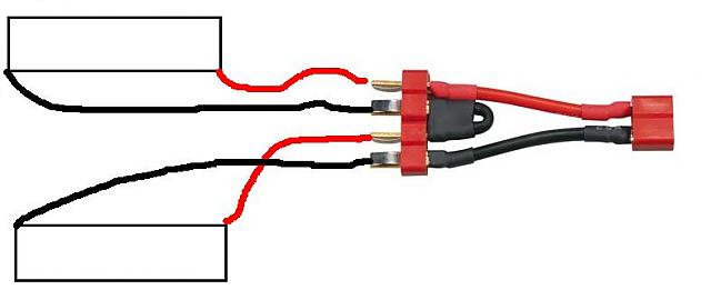

Thanks alot, i was looking at my Y adapter and it is solderd with the red connecting each other, so im going to re do it and make it where the postives connect .... will it harm the mamba max ? run times decrease ? how much more power will she get ?..im getting exicited now
ridinbikes247
Posts: 14
01.05.2008, 02:05 PM
is this how i should do it ?

01.05.2008, 02:20 PM
Yes, that is a series connection.

01.05.2008, 02:28 PM
right on... thats the way.
