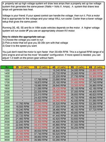

You guys know how I feel about those MF that are over there putting out BS rules. Those CS will drive 1/8 electric to the floor. Like I've been saying and I won't say it again, HIGH MF VOLTAGE is the way to go with 1/8 scale buggies and truggies and those MF are too F stupid to realize that. How the F do they want to make it safe when most of us know that 3S and 4S will most of the times make the system just run hot. A lot of guys runs 5S, but 6S is much better. If I can get 10 minutes on my 6S 2200mAh, I should be able to safely get 15 minutes from a 3300-4000+mAh for a main. I saw a nice chart that was put up over at rumrunnerracing's forum and here is where it came from (I think) http://www.impaktrc.com/product_info...oducts_id=3076. I've been saying this for how long now. I know a lot of you won't agree because you've never tried it and when you get to know the Kv that will work efficiently with your voltage then you'll be glad you tried HV. I will not be using or recommending a 2200Kv to run on 6S. I'm not going to mention the company's name, but they should've went with a 1300 to max 1800Kv with their 6S controller. It's sad that ROAR has no clue what they're doing when it comes to 1/8 electrics. I'm sorry if I had to go that far, but I might be seeing 1/8 electric die before it really takes off. If I made anyone upset, I do apologize.
Regards.
Name:	Motor KV_Batt.jpg

haha latin blood - I'm 5s on 1650kv - works for me :)
