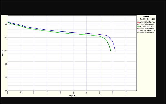

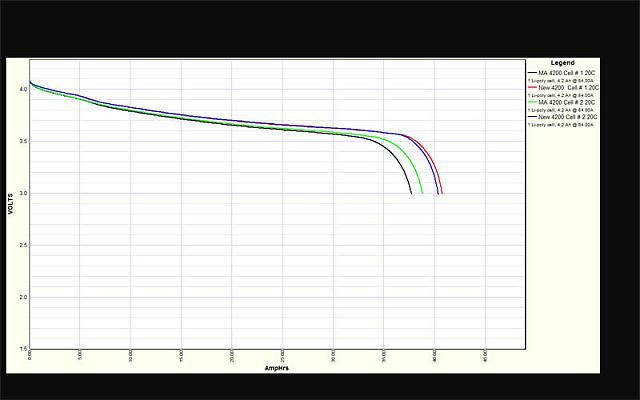

Awesome! Graphs! It might be my monitor, but could you blow them up a bit so I can read the numbers? Any temperature data and 1c, 10c, 15C graphs for comparison would be nice too. Especially temperature that is needed to duplicate these rates.
It is really nice to see some data finally, bravo Austin.

Looking at the graphs a bit harder here, it seems that the average voltage is around 3.6v/cell. Wouldn't this indicate that running them at 20C is not the max continuous rating, and that they could be pushed quite a bit harder? But at the bottom of the 3.2a/h cell graph it shows 12a/h on the discharge?
edit: my eyes hurt, I will wait for you to enlarge them before I try to read any more

I'm with you there JRH, I put it on photoshop 11 and blew it up, cleared it up as best I could, and still can't make out the numbers well enough.

Sorry for the small graphs...
There are larger versions here
http://www.nitrokillers.com/forumdisplay.php?f=117
John-I am not seeing the 12ah that you are referring to.
The tabs that we use are copper, not nickel. Copper is 10X more conductive and our copper tabs are very thick. Twice as thick as most the manufacturers I have seen. They can handle those very high amp draws in bursts. I think I have an eagle tree showing bursts in the 250 amp range. I will see what I can dig up. Very few setups are running in this range.
At 20C average, a pack will last 3 minutes. Most guys will set up for a longer run time than that unless they are drag racing or doing speed runs on boats.
With the expanded CBA we were able to do burst at 120 amps. I will try and dig them out or get them tested again.

The temps were all between 85-90 degrees at the end of the discharge. Keep in mind that this is without shrink wrap on the cells so the temps would be higher in a pack format but no where near the 140 degree max.
I will try and get the high def versions of these posted here also so you don't have to squint.

Jason swapped the graphs; he swapped the 4200 with the 3200.
are these graphs provided by the producer are are these own measurements?
And can you share what equipment was used for testing?

There is a 12Ah there.. the scale down the bottom on both graphs goes to 10x the battery capacity. Instead of 4.2Ah its 42Ah... it even says it on the side that it was measured at 32Ah, or 40Ah... is that a 10p pack or something?

my guess it's just a scale error, i think a bug in the software or such;
The capacity and voltage are setup correctly; I assume the software automatically scales with the variables you can put down in these fields.
