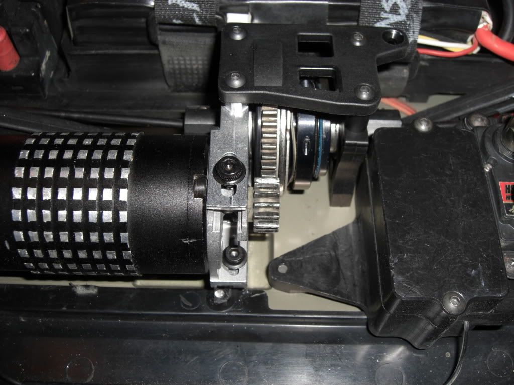

Not sure on the Durango fitment - never had one in my posession to make the call. most likely, the Slipperential will fit, though.

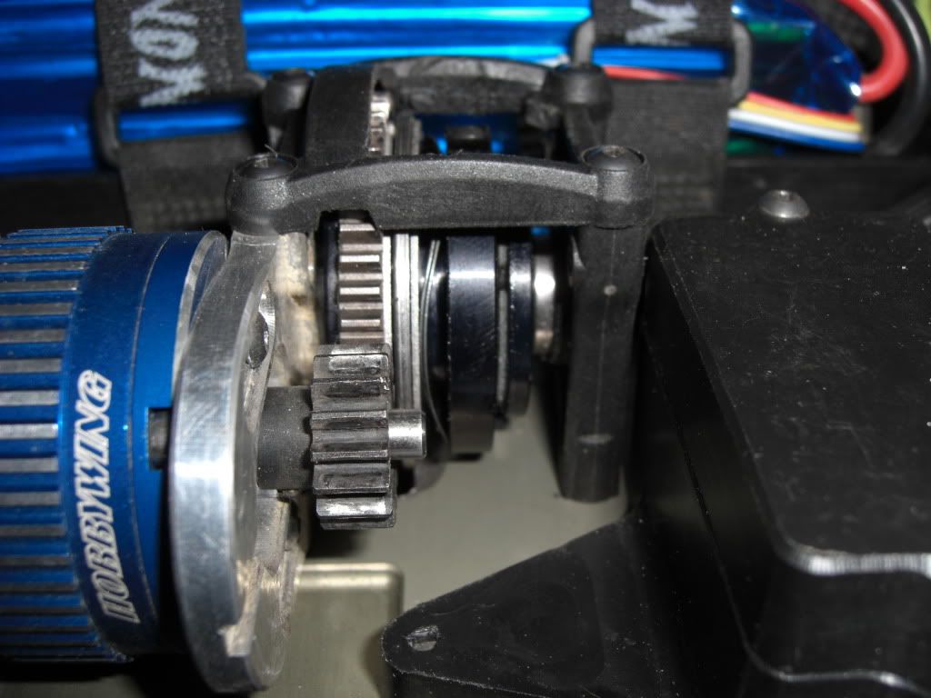

Slipperiential requires 1mm to 1.1mm shim to fit in DNX408.
Bearings should be replaced with 8*14 mm flanged bearings which come with DNX408.
After that you are good to go.

I've seen the question asked, but no response. Would this work on the O'Donnell Z01T? Please let me know. Thank you.

Yes, it will fit the O'Donnell buggy and truggy - it will require some shimming, as it is physically shorter between the bearings.
