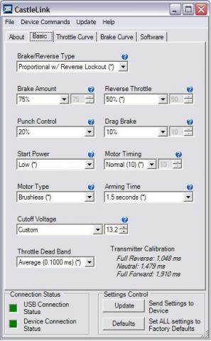

Powering first time the system had some difficulties. Fan keeped blowing, Leds were all on and no response throttle nor steering. Figured that I didn't Bind my receiver with the radio after making a new profile for it. So it didn't get signal.
Did a little test run outside. It runs very well, can't really say about the performance yet, traction isn't best at ice/snow. Front wheel flyed off though..
Throttle is smooth as a butter, a light year ahead from my bk controller. Temps were quite normal for this weather motor 30C° controller 35-40C° outside 0C°. Batterys were... cold
And another thing. I was suprised that 14t mod 1 pinion was too small. It barely touched the spurs teeths.. So had to settle for 16t.
I tweaked Esc's settings a little. Should I change something?And about the brake amount, is it all the same if I tune it from the radio or from the esc's setting?

I have things adjusted a little different, but not by much. I have the punch control at full power, alot less brake, smaller throttle deadband, auto lipo, and a faster arming time. Just pp on how you want to run your truck. If I were you I wouldnt mess with the punch control, you can use your transmitter to tame your truck if it is too wild. I usually slow my trucks down when I go to the track and speed them back up for bashing. I get too power happy at the track.

Thanks for advices, have to explore the settings more. It runs fine though. I guess I have to wait till snow melts a way.. Then I can start the proper tests.
I would like to hear other ppl's opinion too.

I just thought of why I lowered my brake settings. Sometimes under hard braking, if you go from brake to gas quick the motor will cog. Not sure if it will do it for you, but it is something you should be aware of.
