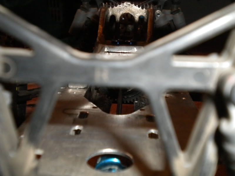

Here is a quick teaser shot, it doesn't show very much at all and that's the whole point. However, you will notice the current design with the foot on the bottom of the motor mount to bolt to the chassis, nothing new there, but there is something added in the picture, and there has been alot taken off the mount since the picture was taken. I've gotten my re-design aluminum finished, just some basic finish work with the Dremel to do and a couple holes to drill.

If RPM made MGT shock towers I'd buy them. I would prefer them over aluminum ones actually, since I'm not going to add a wing mount or anything like that.
I'll take another teaser picture of my motor mount in a bit.

Here are some more teaser pics of the motor mount. I will say that it is done minus finish work and 4 more holes that need to be drilled. I have not tested it yet but it will be stronger than the previous design as it will be more securely mounted. Think of how they pick up smaller boats (in the 40 to 130 foot range) from the water, and that will help with figuring out my design.
