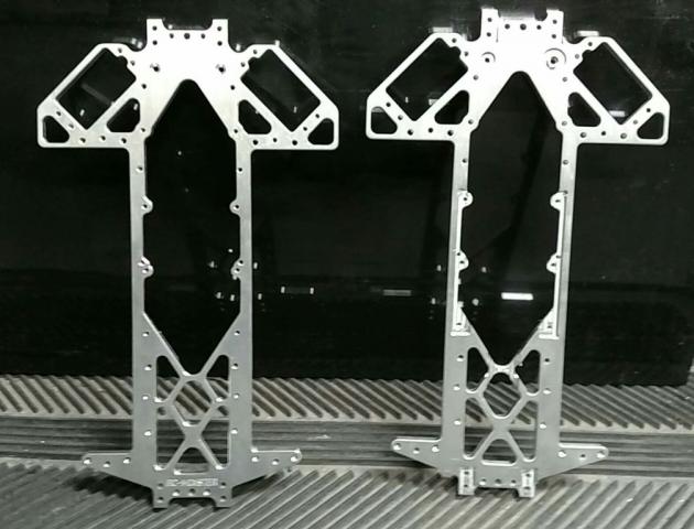

Made a few minor tweaks on the V-Maxx chassis to accommodate the new center skid with 2 diff location possibilities. I enlarged the center opening(added clearance) so the diff assembly can be mounted more towards the rear - particularly useful when running the chassis extensions for optimum weight balance. Also, the chassis braces are now threaded instead of the chassis plate itself, and the underside of the chassis is cut a little deeper(adds pre-load to the servo saver and lowers overall Cg) - The tranny mounts are also no longer recessed in the top of the chassis.
