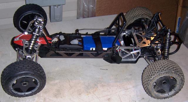

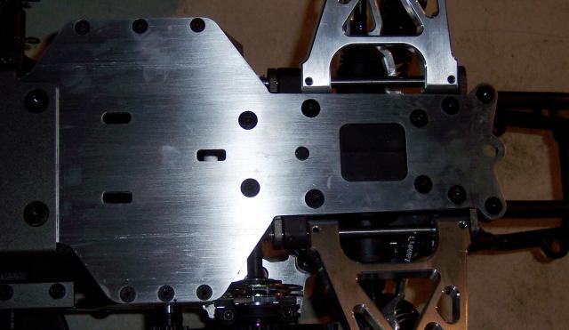

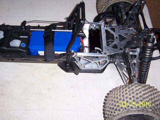

pics - 03.15.2010, 11:40 PM
A few pics. :)

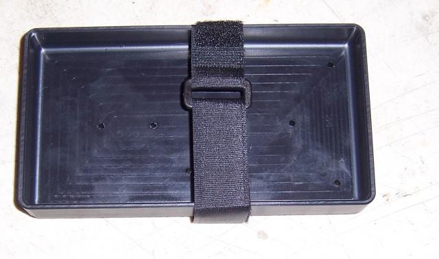

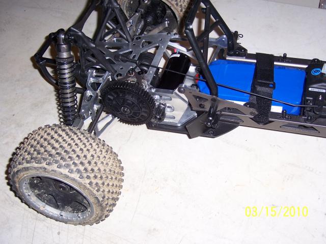

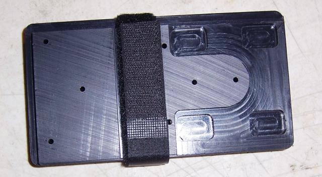

pics - 03.15.2010, 11:51 PM
a couple more

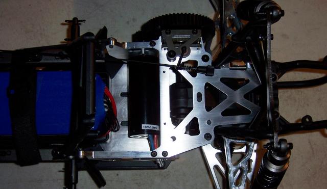

  (#176)
billy gunn
03.16.2010, 12:01 AM
I like the looks of your conversion. Looks very clean.
Looks like you have to run your custom transmission plate? It looks like your plate is the same thickness of stock, have you thought about running it thicker like the Turtle Racing plate?

  (#178)

Location: PA
03.16.2010, 12:12 AM
The lower plate is thicker than stock - stock is 4mm, mine is 3/16 (4.8mm). I had to mill extra pockets so the plastic skid would fit. The motor plate and chassis brace(opposite motor mount) are .325" thick(8.3mm) and are attached through the bottom of the lower plate, to the top of the rear bulk plate and to the main chassis extrusion - it is quite solid/rigid.

Location: PA
03.16.2010, 12:15 AM
Gonna try a Phoenix HV 110 next. It will ultimately use the Castle HV car version when it is ready(will beta test on this rig). I also have the HV180 boat ESC that works well(ran previously). The motor installed now is a 1527/2.5D and the battery is a 6500mah 35c/65c 7s Hyperion G3 geared with a 12t pinion on the stock spur. It should do alright for now. :)

03.16.2010, 12:19 AM
Thanks, didn't even notice the first time around that you machined a new rear lower chassis plate. Will you have a motor plate with spacing for a 22xx Neu as well as the 15 series?
