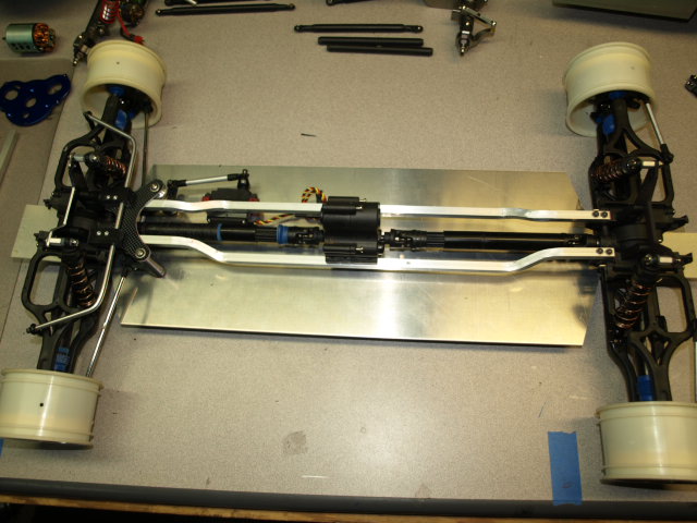

I started a build thread and began searching for more info and found this great site.
Here's my build:
Watch here as I transform once a Emaxx crawler into a HUGE 1/5 scale High Power Brushless Lipo powered 45+ MPH On-road Drift Car and Rally jumping 4WD sedan
Always Wanted a BIG RC !:-P
Parts on hand
1/5 scale Sedan Body- free
E maxx Axles assemblies,
lockers
A arms- 15" wide
Revo shafts & knuckles
Emaxx 2 speed Tranny
emaxx shocks
Custom made chassis Alum.
ESC Mamba Max

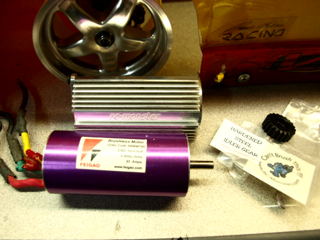

Just bought :
RC monster Steel Idler gear
Motor Feigao 7XL 2382 KV
HPI steering assembly
2.5 mm T6 aluminum for chassis
Wheel base 20.5"
Width 16"
Length 36"
Height 9.5"

What Gear ration Spur Pinion should I start with ? with the Feigao 7Xl Motor
any battery suggestions ? Possibly Two 2s 11.1v Lipo ..?
need on road tires too
Thinking of using XTM large buggy wheels 5" x 2.6 wide 17 hex

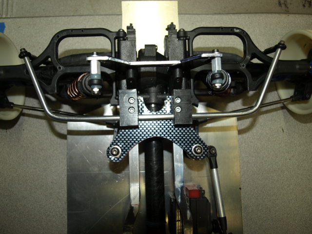

Preparations:
Emaxx Tranny locked in 2nd
upgraded idler gear
1st gears removed
Emaxx axles locked
Feigao 7XL 2382 Kv motor
Mamba Max
Thank you

oh the motor is Feigao 7xl 2382 kv

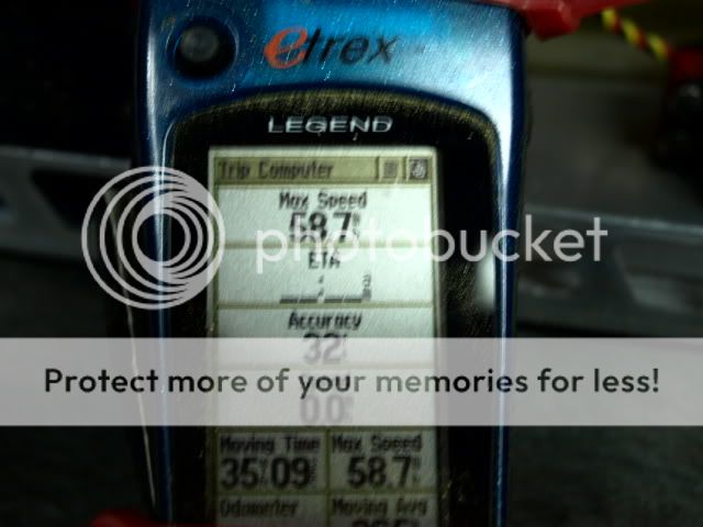

Looking for mostly power torque speed would be nice in the 40's
Found this AWESOME SPEED/Motor Calculator but it's hard to figure what gear set
Looking for a 5mm shaft pinion , not sure what size tooth pinion though, any suggestions.

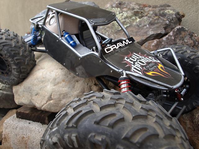

Humm , not sure just yet how to fit-add a Cap on the mamba, Castle tech said it will do well because they are so over built.
I'm stealing the MM out of my Latest Creation Full Throttle custom Super Crawler, build thread just added to my sig, it's got 6 watt 4 speaker MP3 stereo loaded in it complete with Real V8 engine sound.

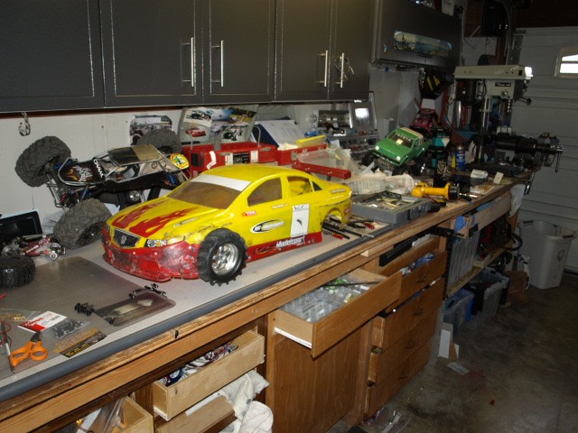

Here's a sneak peek
My latest creation below
Console shifter turns car on
twin stick turns on stereo Amplifier
Sony MP3 with Tunes and Real V8 engine sound
18" wheel base 14" wide
Axial trans
Revo drive shafts
Losi aftershock Diffs, custom lockers
Hyper 8 shafts
Xtm hubs
custom SS axle tubes and Knuckles
1/4 Tube steel MIG welded Chassis
2wd, 4wd and DIG by Remote
HiTec 7955 front rear steering servos
Castle bec
Mamba max
Climbs great when tires are working, Moabs stink

Here's a sneak peek
Axial trans
Revo drive shafts
Hyper 8 shafts
Xtm hubs
Castle bec
Mamba max
